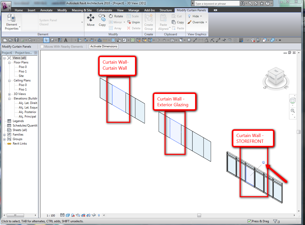

I had the same problem and it was driving me crazy because everyone was just like "just select the panel and scroll down in the type selector what you want to change the panel too".  Like I'm not clever enough to think of that.  It turns out that you have to unpin the panel before you can change it.  I don't know why it doesn't tell you that in the Revit help files because the default when you create the curtain wall is for all the elements to be pinned.  There are not circumstances where you will not have to unpin the curse panel.  All you do is select the panel, go to EDIT and down to unpin.  This will unpin the panel and you will be free to change it into any wall type or curtain wall door that you choose.

"There are not circumstances where you will not have to unpin the curse panel." - Not true, you ONLY need to UNPIN the panel if you create a "Curtain Wall - STOREFRONT"
