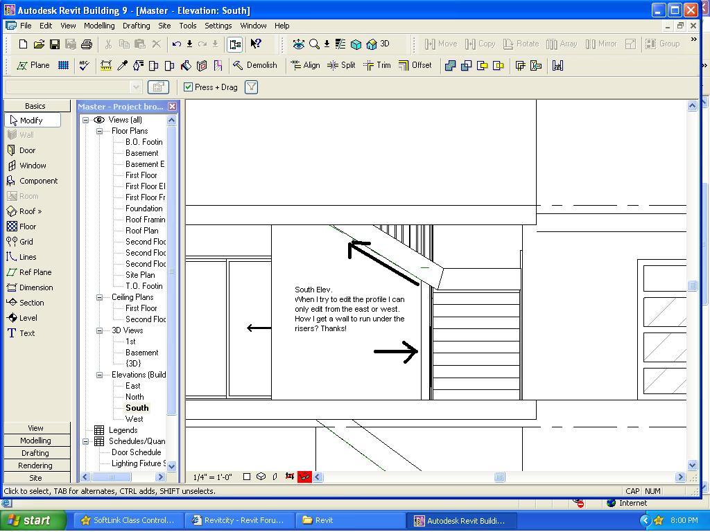

Ok, I'm very new to Revit and have tried EVERYTHING I can find on here, AUGI, ect...I need an angled wall to hide the underside of my stairs in a room. If I try to edit the profile is forces me to a view facing the face of the wall rather than the side making it impossible to draw the angle I need. I'd attach my drawing but I can't figure out how to save it under 2mb...arg! frustrated college kid, Alex

I don't understand. Isn't the face what you want to edit the profile in? Or are you saying your wall runs parallel with the stair treads? What you can do is post a screen shot in jpg format. But if I'm correct in thinking what you want, you have to create like a floor or ceiling or roof with a slope angle on it I don't think you can angle the top of the wall unless you attach it to a roof. Post edited on 2006-10-19 18:51:44

Sorry about the confusion, my brain is shot after 3 hours of forum browsing looking for an answer. Heres a pic of what I'm working with, I can upload a zipped rvt. when I get home if that helps...thanks for the quick responce!

draw a reference plane unter the stairs draw the wall in plan view atach the top of wall to reference plane you may have to name the refplane hope this helps

Im not sure thats what upitycracker is trying to do... upity: Are you trying to lay something more like a ceiling under there to hide the stair structure? If so you'd be better off using the ceiling or roof tool and defining one edge as slope defining. There is a way to lean walls out aswell as edit their profile, but it involves massing and gets pretty tricky as I understand it, if what youre trying to do is what I think youre trying to do, supplimenting a roof for the wall is a better workaround. If this isnt what you're trying to do, could you explain again for us slow people please? Hope this helps! Post edited on 2006-10-19 22:08:12

Yeah, I just need a ceiling to cover the bottom of my stairs, no wonder I was having to much trouble...Thanks for all the help, I'll give it a try next time I'm in class. everybody have a great weekend!
