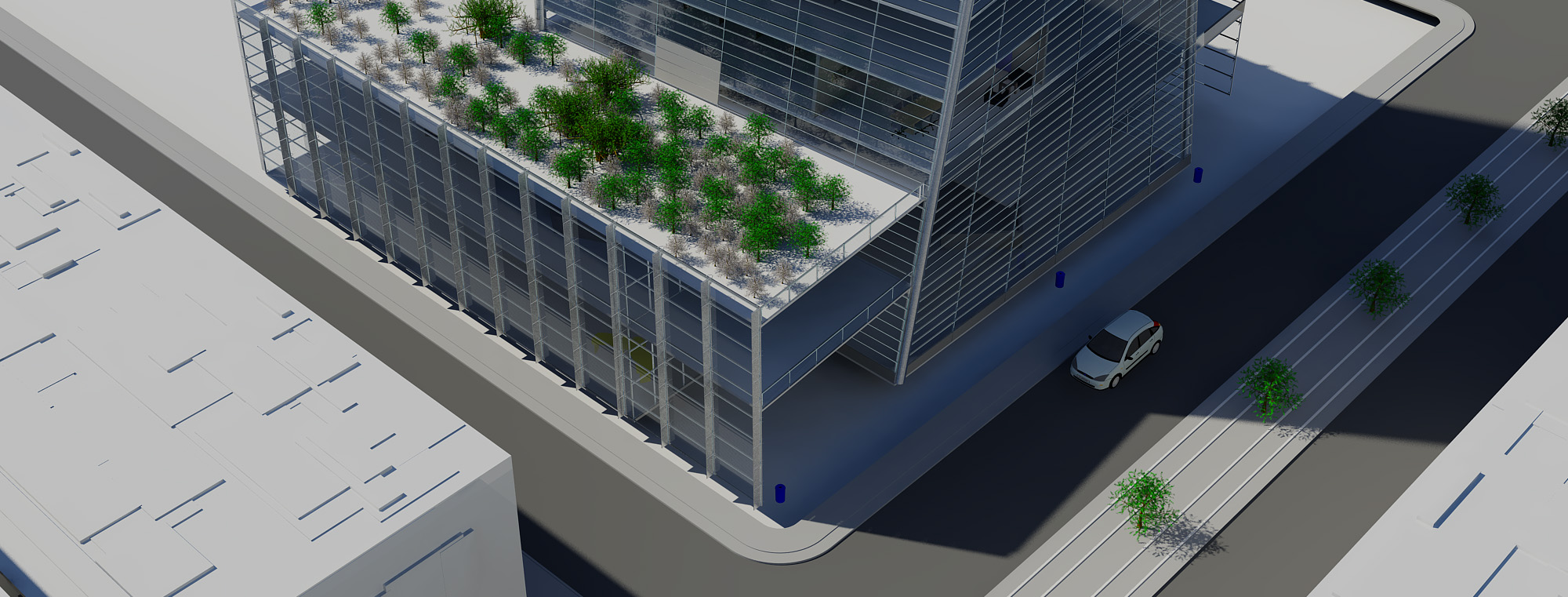

when you "File link" or "Import" into max a 3d dwg from Revit be sure to choose Split objects by material...
Then in the material editor click "Scene" select a revit material and then replace with the material you like from max...
here are some renderings using that workflow with some geometry added in max.
