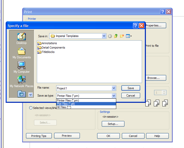

The printing company that we use most for printing our plans needs a plot file (file extension .plt) to print. It will make .prn files for me all day long when I check the "print to file" box. Am I missing something really basic that I can't get Revit to make a plt file? Thanks for any help. Post edited on 2006-10-11 12:33:57

When you get to that point where you name your prn file, click the browse button. Select the "Save as File Type" pulldown. Select plt as your file type. Todd Behning RDG Planning & Design www.rdgusa.com Post edited on 2006-10-11 12:02:16

Thanks, works like a charm.
