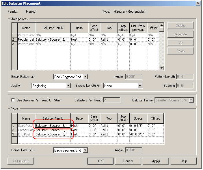

How can I modifiy a railling on a stair so it meets the ADA standards? I downloaded some cool componet hand rails for the begging and end but I am unable to figure out how to place them in a project. Does anybody know anything about rails?

In the railing properties you want to edit the "baluster placement" settings - you would use those great handrail components as the start and end posts in the baluster layout.
