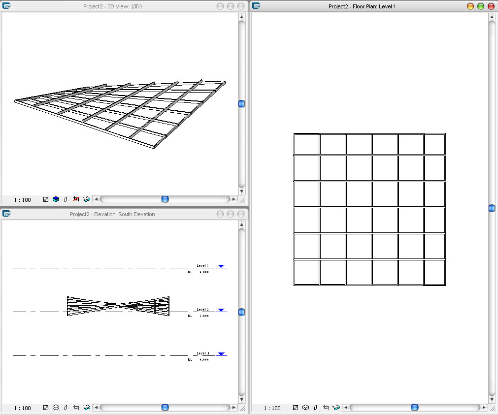

There are multiple ways to do this... 1. In 9.1 you can create it using a structural beam system. or 2. a sloped glazing system with an empty system panel.
Regards,
Chris.

please remember for all who are considering this that all the for points are on four different levels....thats the big challenge here...thinking about it, i think we can achieve it by doing a void blend(mayb two) for a extruded mass cube...and then say create roof by face...
Thu, Oct 26, 2006 at 4:58:32 AM | RE: roof
nandini
Joined: Sat, Jul 30, 2005
58 Posts
hey, i was working on this and realised there is no need for a void blend cut off...we can achieve the same with blend itself....and assign different elevation to all points.
