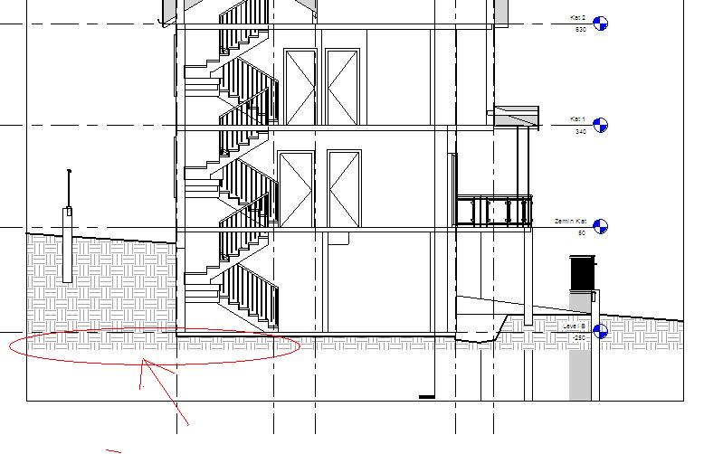

how can we control the depth of earth fill ? thnks.
Mon, Sep 18, 2006 at 8:00:24 AM | RE: bottom line of earth fill?
sjs
sjs Avatar
Joined: Thu, Mar 11, 2004
41 Posts
3.5 Stars: 10 Votes
Settings -> Site Settings -> Elevation of poche base
