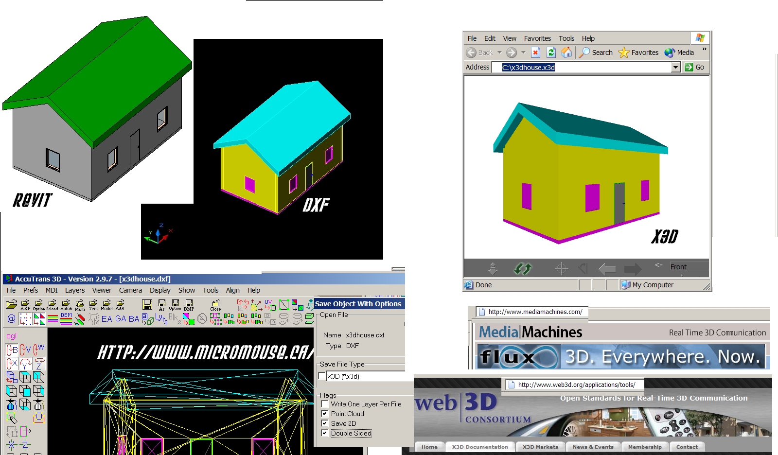

An experiment converting a .rvt-file to .x3d. To follow the experiment take a look at the image house.jpg. You can see the house in REVIT. Saved as a RVT-file Then I exported the house as a DXF-file. And you can see the result. The colors have changed... There are no more glass in the windows!!! Then I used Accu Trans from www.micromouse.ca to convert the DXF-file to a X3D-file. You have use File > Save Object with Options and choose Double Sided. And I could open the X3D-file in Internet Explorer using a X3D viewer called Flux Player from www.mediamachines.com. And the result is as the same as the DXF-file. It is possible to bring back the glass, but a little more work, some other day perhaps... To find other alternatives for editing, converting to and viewing X3D you can go to http://www.web3d.org/applications/tools/ If Revit could save as X3D then it was a little easier. But this functions! and not!!! And if Revit could open a X3D file then.. it was so much much more easier. And if all other CAD and 3D programs also could do it, then.... It is coming but so slow.... There is a need for X3D, really.... The whole building industry needs it, but... we are not all presidents... yet But it is coming....

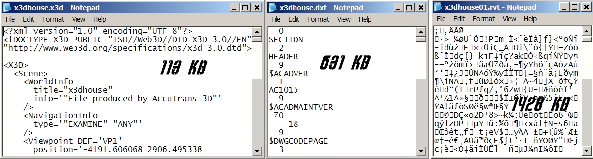

Take a look at the image notepad.jpg and you can see how three different file types describe the same house!!! The X3D file is only 113 KB and it has a structure. It is a STANDARD from W3C. And it is as safe as it can be for the future... If programs like Notepad exist in the future. Your children and their children can have a look at the house you designed.... The DXF file is 631 KB and you can read it. But it has no structure. It will be hard for the ones living in the future to understand what it is. Perhaps some recipe on turkey.... The RVT-file. Well I do not understand it. Perhaps you do. I do not think it is safe for the future... Do you? And it is 1428 KB. Perhaps you can understand why I am so interested in X3D and SVG and all other mark-ups made with the XML grammar...
