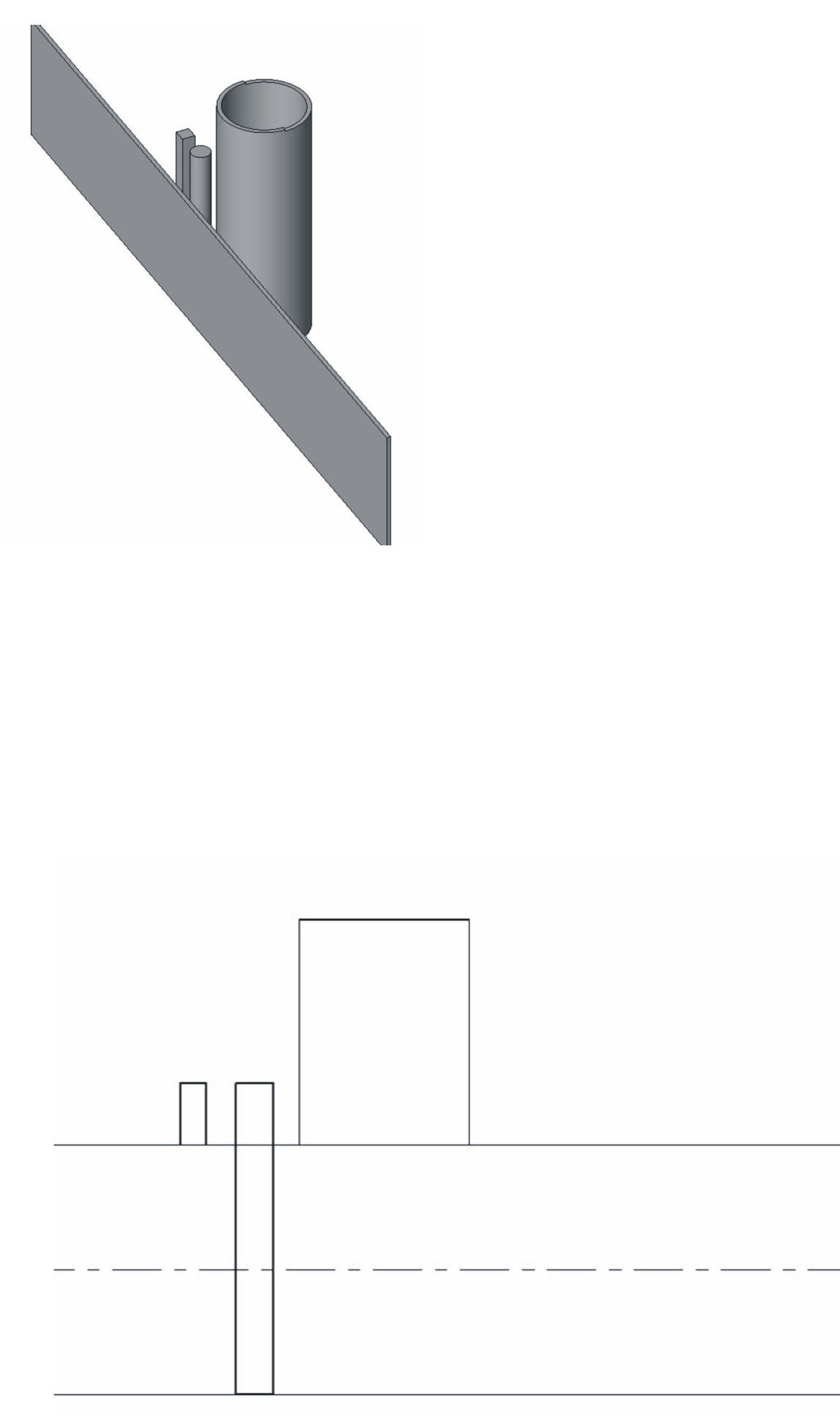

Here is another example of the Line work Tool Problem ( Revit 9.1 ) . Try creating these column and wall elements beyond a wall. ( 1st Image) . Then look at the south view and use the line work tool with wide lines( 2nd image) . The rectangular column works OK it gives you grips so that you can adjust all lines above the wall. The Round column freaks out .. it puts a wide line across the whole object. In the circular wall only the top is wide with the line work tool, the 2 sides does not take the wide line. Any Solutions ?
