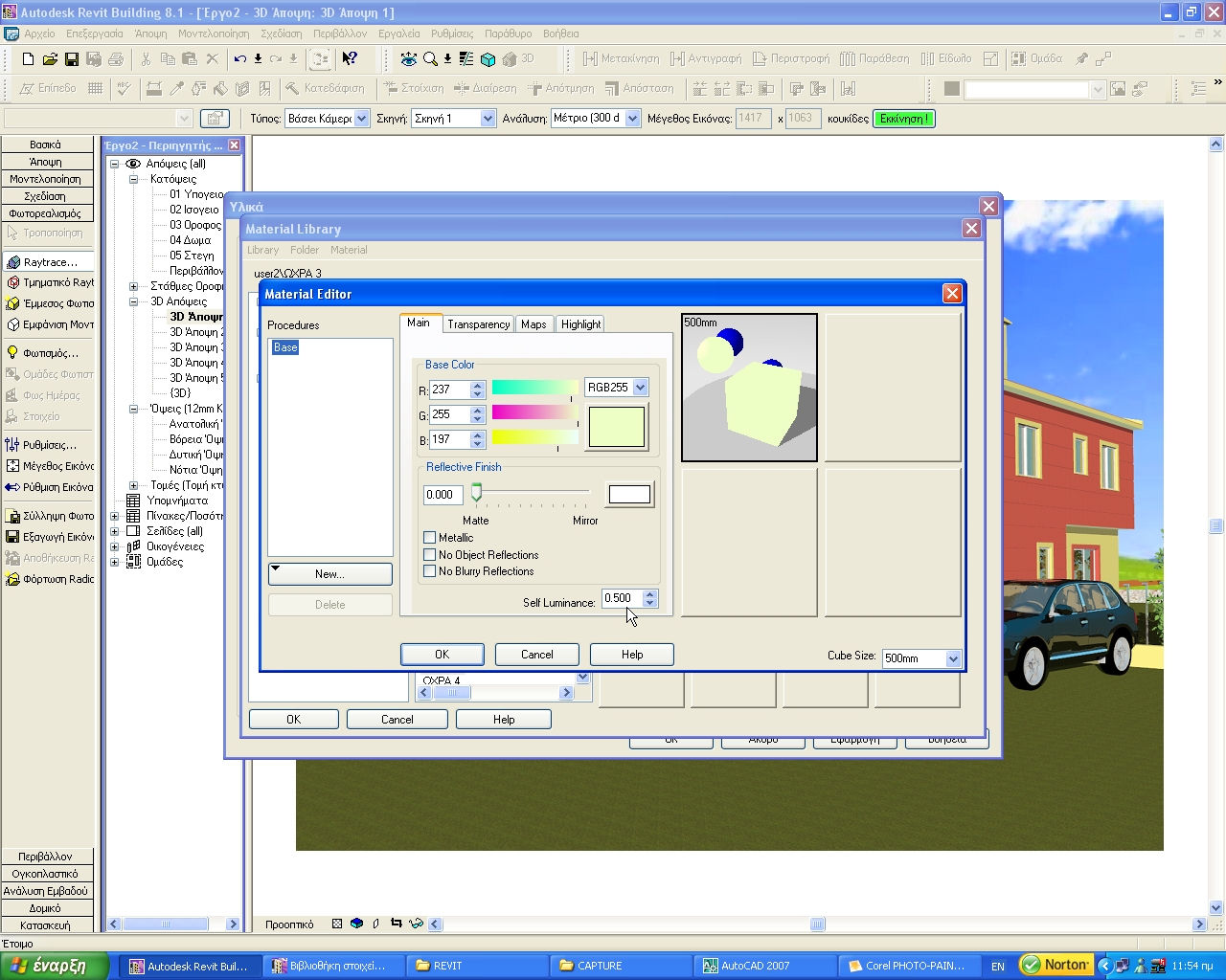

I dont know where you can download some materials.If you find some tell me because I'm looking too. But i think the solution for your problem about gray appearence of white objects is to make a custom material from a material of your choise. Save it in "User" library and then right clik on it and select edit. Now to "Main" tab change value 0.000 to 0.500 to "Self Luminance" space. I hope to have a good apearence now

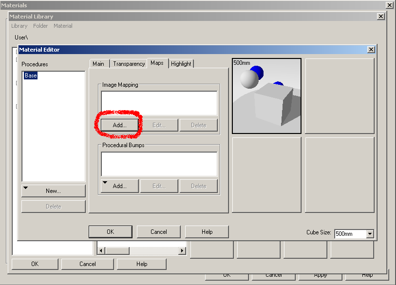

You can also make your own materials from Jpg's.All you need to do is map it in your new material. Post edited on 2006-09-15 04:53:07
