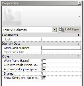

Edit the column family, Go to Settings-->Family Category and Parameters and untick "automatically joins geometry with walls". Then reload the family. HTH.

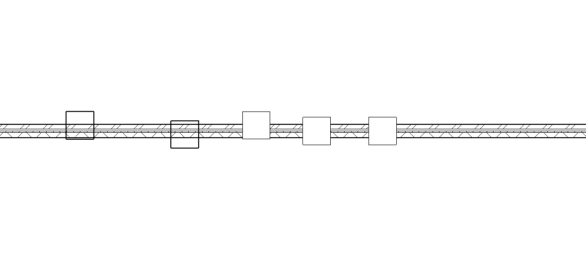

i am using revit 2013 ...i have the same problem ........ unjoining geometry sometimes works and sometimes it doesnt . i dont know why . see the attached pic ....
please if anyone figured out the solution for this please post .... thanks

these are unjoined architectural columns ... the detail level is set to fine ... i know there is a deference between architectural and structural columns .. but what if i want to use architectural column and i want to cut it from the walls !!

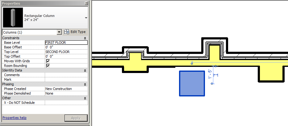

Here is my stock architectural column (2013) placed in different locations and my family's properties.  What are yours?  Obviously different than the stock.

Stock vs special   .... the one that comes with Revit....   not one you created or loaded from somewhere else....
WHAT ARE YOUR FAMILY SETTINGS?  Look at mine.- the right image.

ok see the 2 attached pics.... theses are my architectural columns ,,
