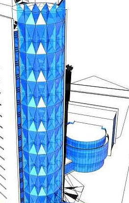

i have a facade composed of irregular pyramits in 3d..which is the best way to model it in revit?
these done in ACAD.

Create a family for each rectangle. Set a reference plane for each facit. go to a 3d view and orient it the to the reference plane. Draw the solild Repeat for each plane and rinse.
