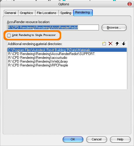

Mon, Aug 28, 2006 at 12:51:47 AM | RE: ray trace
Mr Spot
Mr Spot Avatar
Joined: Mon, Jan 12, 2004
2889 Posts
4.5 Stars: 93 Votes
It's been there since version 8.1 at least.
