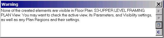

Problem: I can see lines and reference plans. I can modifiy them. But if I create a new one, they disappear and I get this message (see attached file). I get this error message in all of my views. Please help.

Have you checked all those places it tells you to check? If so, the only piece of information I can pass on is that unless your perpendicular to the reference plan.....you wont see it. Visibility Graphics is the best place to start. Good luck. Kune

Yes. I have checked all of those places. I have also looked into the visibility graphics. The thing is that I can see the lines already drawn that I am trying to re-create. If the visibility graphics had them turned off, then I would not see them in the first place. I have gone through the Visibility graphics a few times and can not figure it out.

I believe your issue is in where you placed the ref. lines. If you placed the ref. lines in a different view they will not show up in another view, therefore the error that they are not visible in the view. Also check to make sure you are adding ref. lines or planes. Lines will not show through to other views. Planes will show through if perpendicular to view. I would first check your other views to see where you placed the lines or planes. I had a similar problem alot at my previous job. HTH. Post edited on 2006-08-15 14:35:04

Thank you sir. The file appears to be working now.
