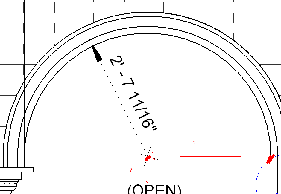

Tue, Jul 29, 2008 at 3:02:57 PM | Dimensioning to the centerpoint of an arc
CADVANTAGE
Joined: Fri, Mar 3, 2006
9 Posts
oK Revit-eers,
How do you liniar dimension the radius point of a radius dimension itself: say in this arched opening in a wall in elevation.
There is no center mark check box. My sketch could on a in-place opening, but it turns off when I finsh
Tue, Jul 29, 2008 at 3:09:34 PM | Dimensioning to the centerpoint of an arc
CADVANTAGE
9 Posts
The wall and line work as far as showing center mark work great. But what if you want to linear dimension to a radius point dimension?
Tue, Jul 29, 2008 at 3:50:19 PM | Dimensioning to the centerpoint of an arc
mhans
Joined: Tue, Nov 7, 2006
456 Posts
3 Stars: 10 Votes
You could always draw a reference plane that passes thru the center of your arch opening. Dimension always snaps to ref. plane.
Motto: "No Post left behind"
Tue, Jul 29, 2008 at 4:11:55 PM | Dimensioning to the centerpoint of an arc
CADVANTAGE
9 Posts
I know I can add that but it is more of a graphic thing lining up tick marks. Just hoped there was a key method I did not know about grabbing that blue grip that shows when you select a rad. dimension - but thanks for the quick reply!
