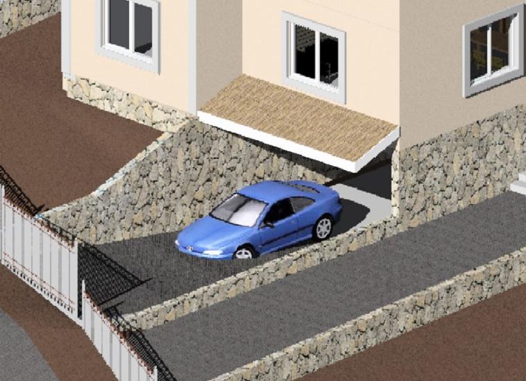

how can i put the car on the ramp?...command "host" didn't work.

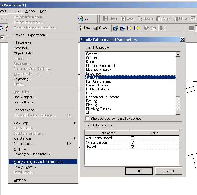

try this select the car edit the family inside the family - settings familycatagory and paramaters choose the family catagory its part of unclick always vertical. that should work

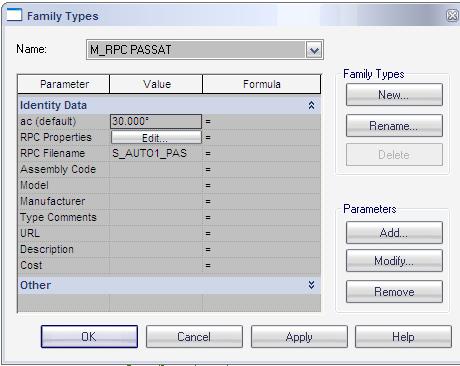

i added a parameter "angle"..and cahange it to 20 degrees but it didn't work...i also couldn't find any thing about being always "vertical" in family settings...thanks for help.
Thu, Aug 17, 2006 at 3:17:56 AM | RE: aligning RPC s?
jfurlong
Joined: Thu, Oct 27, 2005
81 Posts
5 Stars: 1 Votes
you were looking in the wrong place see the image below.

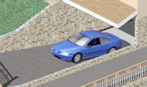

thank you very much..it's ok now.
