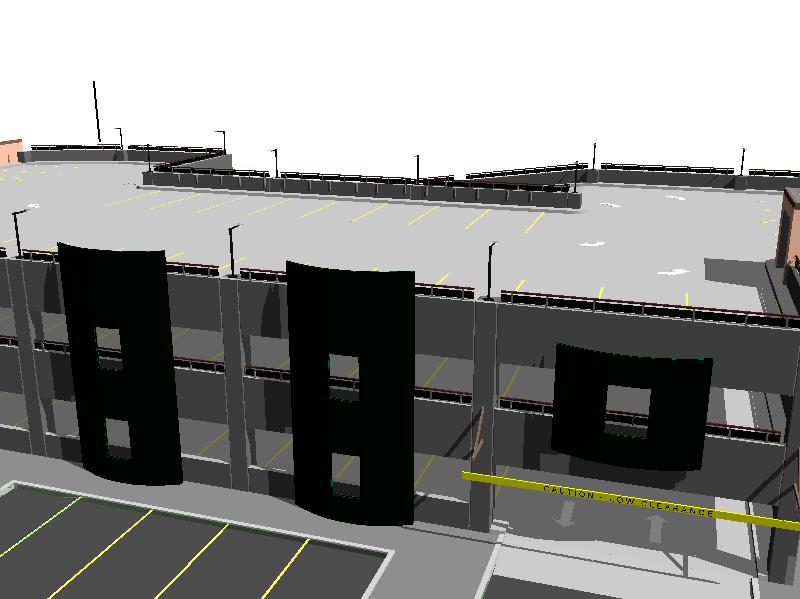

I just finished a 4 level garage. By setting your cut plane, you will cut the ramps at each level on your plan drawings. You will want to set your top level deep enough though so that you see the entire ramp down to the next level.
