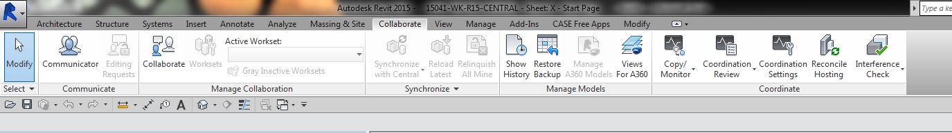

I am having this issue now as well. I have checked that it is not a template file. I am using the correct version of Revit (2015). Enabling worksets is not an option nor is saving the file as a central. It was at one point a central that worked. Would accessing the file via mapped vs UNC really break the file? I thought it would just not let you make a local or access that central file.
It closes with "an unexpected error" every time I try to save. Short of sending it to Autodesk I don't know what to do.

Unfortunately I did not create this file and apparently the user doesn't remember the steps they took to create the file either :/
The problem is even if it is/was a local that was placed on the server, I can't enable the worksets to make it a new central. (see the image) I have tried copying it to a different server, auditing when opening, etc... All of it is greyed out. All the archive files are like this too. I think this person was having issues and just continued to ignore it instead of alert me to the problem. If it can only be fixed by Autodesk that's ok I just wanted to make sure I wasn't missing anything.

If the file doesn't know where the central is, you can't do anything.
Do what I said, use the save as and give it a new name.   I am quite sure that it is 'orphaned' central or local.
