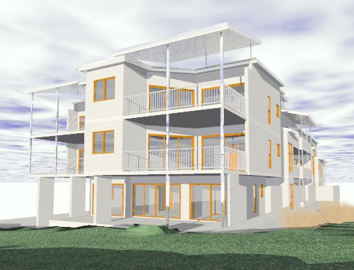

i´m training in revit, making some models, and i've put a car on it, but when I make the region raytrace, all textures appears in white (like u can wee in attachment) ... need I to select colors or something else in first? or i´m falling some step ? if u can give me a help about how it works, really appreciate Smile (n' sorry my bad english) Post edited on 2004-09-29 11:38:47 Post edited on 2004-09-29 11:46:34

Looks like you haven't got all your accurender file locations setup properly... Go to settings-->options-->rendering and check that you have 3 separate locations set up in the additional rendering materials. Of course i've deleted the exact directory locations as mine will more than likely be in a different location to yours but these are the folders you should be looking for. Most likely in the the Revit 6.1 install directory... Mine are data\Materials Rendering\Web Library Accurenderedist\support You can also open the vehicle family and looking in the material settings to see the names of the various materials and check to see they are linking to the appropriate material in the accurender section... Post edited on 2004-09-29 17:22:31
