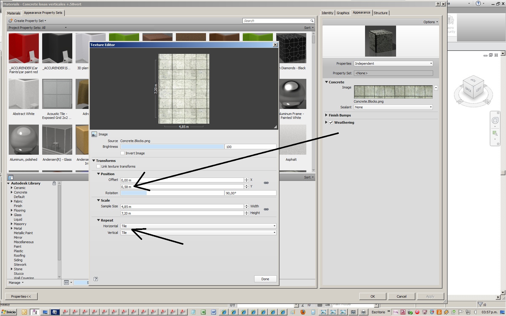

Fri, Jul 6, 2012 at 4:05:18 PM | Texture fix
sllana
Joined: Wed, Mar 2, 2011
106 Posts
5 Stars: 2 Votes
Yes man, i solved that problem by giving an offset value to the mapped image. In your case you must change the x offset for each position. Another way, just a theory, is to uncheck the tile option for mapping (in "repeat" field) setting it to none.
