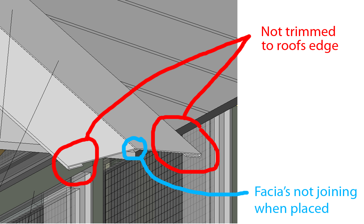

I created a profile.  But when I place it on my roof as a roof facsia sweep, it doesn't fit right.  I just keep the profile flat and then rotated it in it's properties to -9.9 Degrees for a 3/12 pitch roof.  Also the cap doesn't go together correctly beacuse it's two different sweeps since the angle of the roof can vary from project to project.  Look at the image to see what I'm talking about.  Also I posted my profile incase anyone wants to look at that.  Thanks in advance

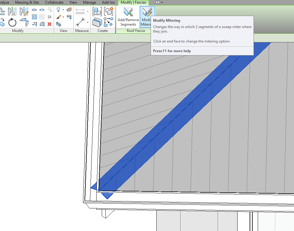

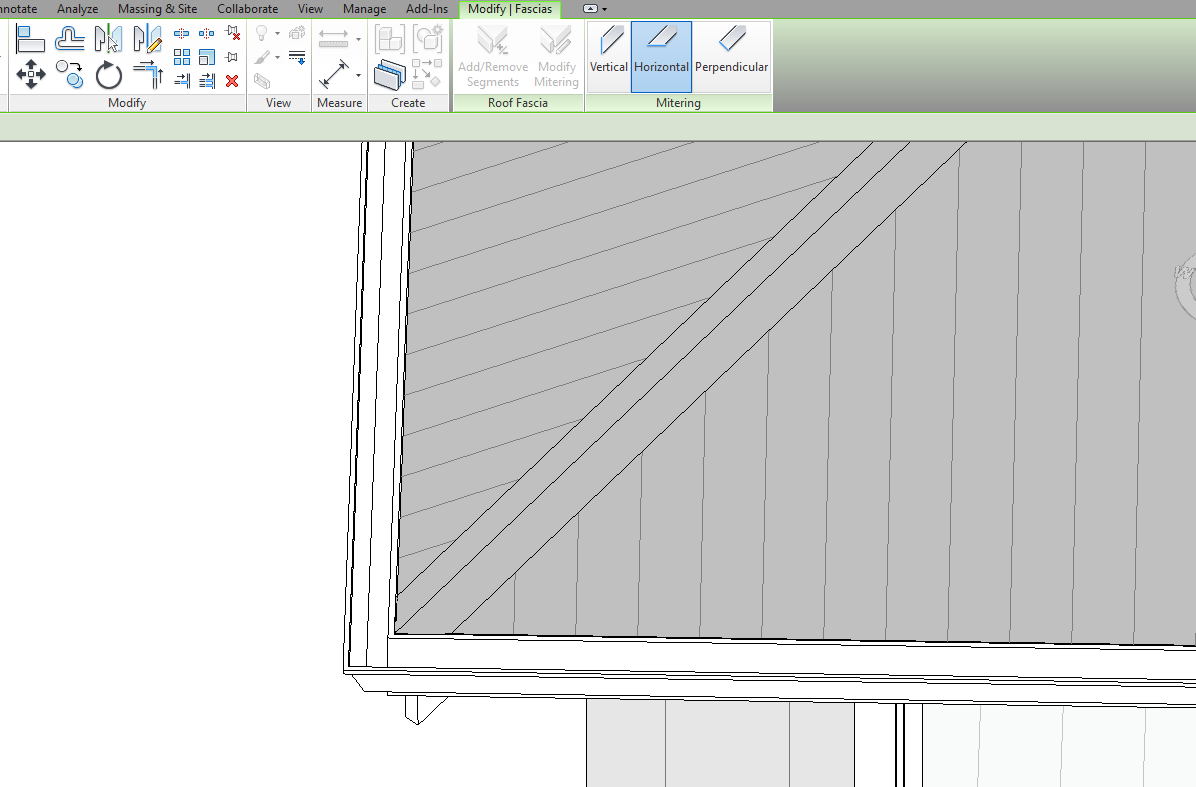

I know this thread is quite old. Anyway for people who are still looking for answers... Creating a new profiles and using fascia tool for ridge cappings is the best way. Answering to lonre17 question. You can adjust end of your profile simply when you click at your fascia you will see option MODIFY MITERING on the up panel button. Then you choose option that fits your needs (in my case vertical) and click on your end of fascia
