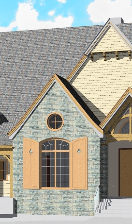

Is there a way to make the end of a revit roof take on a material's rendering characteirsitics? I've tried assigning all the layers of the roof's materials to have materials with accurender settings. It still comes out gray, see attached. I tried to add a thing roof fascia. That's a pain in the neck plus it wont cut off into the desired fascia and soffit profile like the roof.

Use the paint tool to paint on the desired material for rendering to the edge of the roof. HTH.
