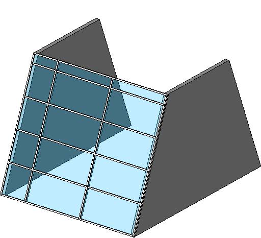

Hi I don't know if I'm missunderstanding your problem but have you tried to create a blend mass with the leaning sides and then go to create curtain system by face and selecting the leaning faces of your mass

I couldn't get into the auonline site without a login and password. Perhaps I need to register. I did try applying a curtain system to the face of a mass and then deleting the mass. I think I can make that work in this application. The tricky part might be getting the mass just right at first. Thanks, this certainly gives me some direction!!

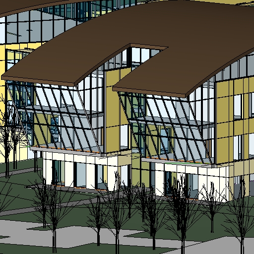

The curtain wall applied to the face of a mass (blend) worked fantastically. See attached jpeg of my model. Thanks to everyone for their help!

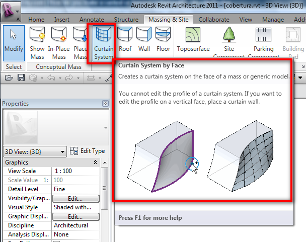

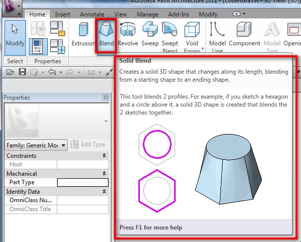

I tried to make a mass and apply wall by face - Revit told me that "storefront wall is incompatable with this command.  Only basic wall types are allowed".
I did a mass by extrusion... i don't know what a mass blend is - could that be the problem?
Wed, Jul 21, 2010 at 1:07:54 PM | How do you make a canted or leaning curtainwall?
#9
Joined: Tue, May 22, 2007
5921 Posts
4 Stars: 205 Votes
You can apply a Curtain wall by face to mass and look what is a "Solid Blend", check your HELP menu...
