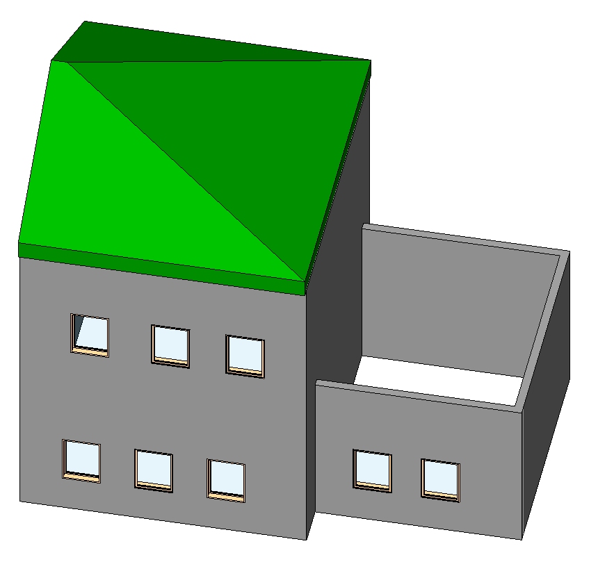

I have difficulties to understand what you want to have just showing a facade of your house. You better show at least two facades and some sections. Or/And you better upload an image from Revit showing what you are aiming at. Perhaps this is what you want to have? Have a look at the image. It is done with two slopes on opposite sides and a slope arrow in between.

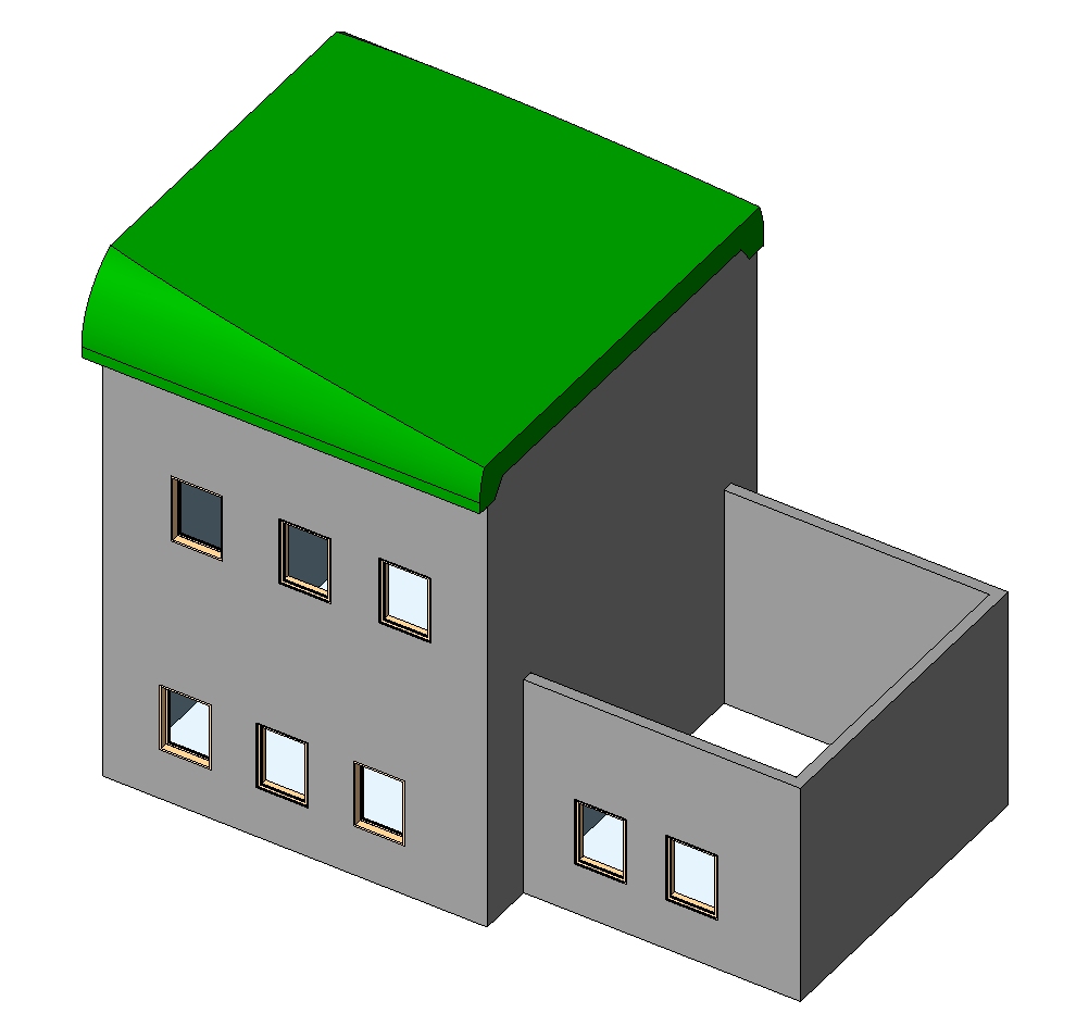

I was a little too ambitious describing Roof1. You do not have to use any slope arrow. Just make sloopes on three sides. Here is another try - Roof2 - that "curves gently". Perhaps this is what you are trying to get? It is made with Modelling > Create > Solid > Extrude and then Void > Extrude Have a look at the image.

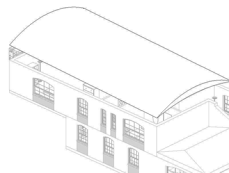

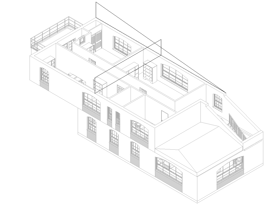

in a way, bot of those are what I'm afte, have a look at the images I up loaded to my Geocities site: Rendering 1 - http://www.geocities.com/simmakkinen/NMFH02_roof1.jpg Rendering 2 - http://www.geocities.com/simmakkinen/NMFH02_roof2.jpg (both above are drafts done in Maya) Rendering 3 - http://www.geocities.com/simmakkinen/SFH02_3D-View.jpg Iso Plan - http://www.geocities.com/simmakkinen/SFH02_roof3.jpg (both above from Revit) I hope that gives you a better picture of what I want thanks for your help Eddie

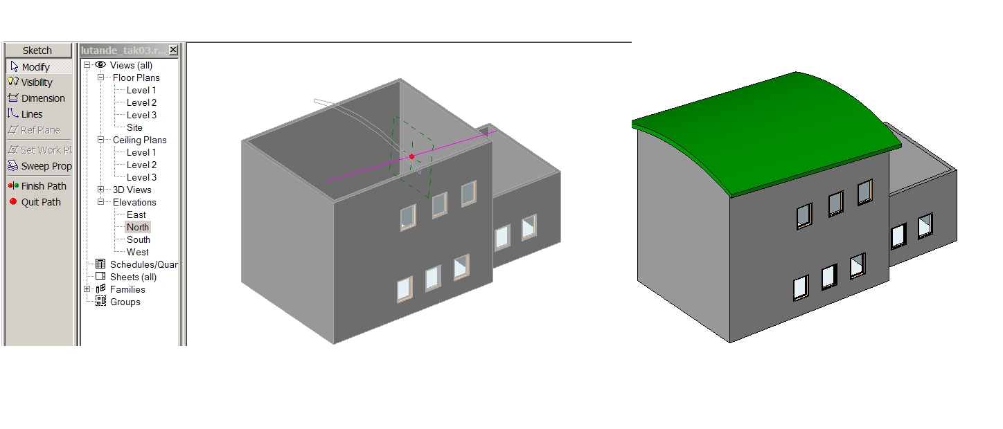

I hope I have got what you are looking for. Go to Modelling > Create Choose Solid > Sweep And then on the menu Tools > Work Plane > Set Work Plane and Pick a Plane and I clicked the facade and got a work plane for the path. I choose Sketch 2D Path and draw a line then Finish Path and click Sketch Profile and you have to sketch a proflle for the roof. Hope you have got it!

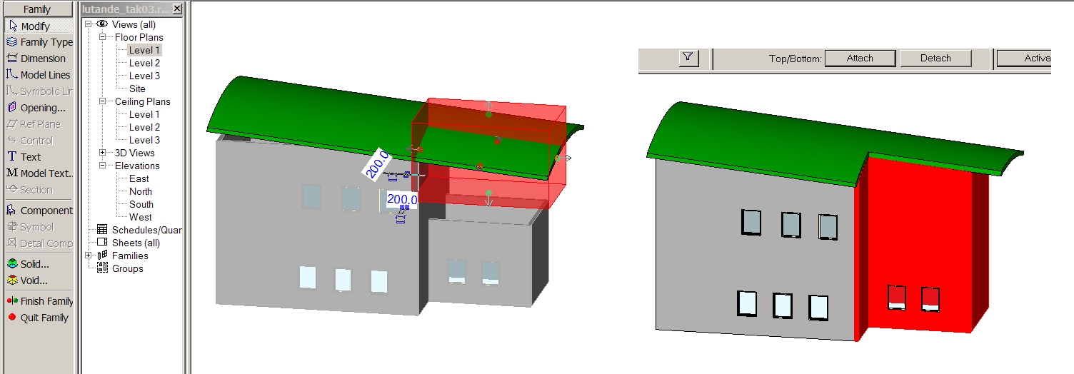

Just a little more tips! After choosing Modelling > Create choose Roofs And then the roof is made you can use Attach to attach the walls you have selected to the roof by clicking the roof. To take a part away from the roof use Void > Extrude before you Finish the Family with the roof.

Hallo again! I have made a new tutorial and I hope you will understand a bit better now...

umm that really helped..I did all of that and got the shape I wanted and placement was perfect...BUT......when I'd done making the roof and went to click 'finish family' it told me it couldn't make it!!! I tried your 3-point arc with the top arc 9.5m wide at an angle of 46* and the lower arc same length at 23* I've tried with the roof overlapping and not overlapping the wall edges, same result, 'cannot make type - Roof 1' - Fromthe pictures in your tutorial it seems obvious that you clicked 'finish family' since you were able to go back to the main modelling tab on the design bar. what am I doing wrong? Eddie

The only message Revit gives me is "Cannot Create Type - Roof 1" there are a few sub-headers saying "Roofs 1 : ID 114076" but that's about it. Do you think it could be a software fault? I tried as you suggested with several other types of lines (straight, box, arc through 2 points) here's an image showing you as far as I can get, after this, the only thing I can do is click 'finish family' and wait for the error message
here's an image showing you as far as I can get, after this, the only thing I can do is click 'finish family' and wait for the error messageShit!
Your image looks fine to me so I do not really understand,
