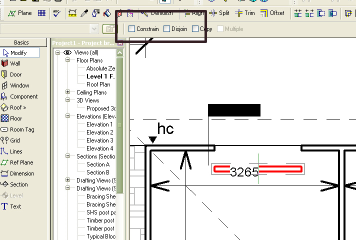

Good morning to you all! I've encountered a small problem regarding walls. It seems that whenever I take a single long wall, and split it, let's say, into 2 smaller walls, and then I try moving one of the walls and Revit still thinks it's 1 long wall... So, my question is, how can I make the walls split completely? So I'd be able to treat each one as a separate wall?

When you move (the command not dragging) the wall tick disjoin on the top command line. Or simply pull the wall slightly away from the other.

Thanks for the reply puzzle, but those solutions don't work for me... I tried the move command from the toolbar, and the walls still act the same. Nothing disjoins itself... Perhaps I misunderstood you... Would you mind being a little more specific? Smile

Have post a screen shot. Not sure if this is what you had in mind. Select the wall you want to move, select move command then tick disjoin. Should be able to change height of the individual walls without upsetting the others. Hope this helps.

Edit: Never mind I found the Disjoin thingie thank you so much puzzle!! Smile Post edited on 2006-07-03 08:28:46
