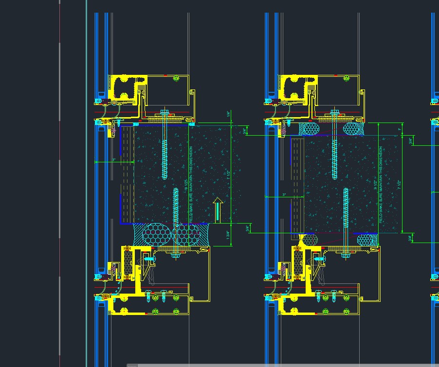

So Im trying to create a glass wall for my project based on the spec given to me. See Screen Shot for that. but basically the mullions are sort of behing the glazing, and the glazing panel overlaps them, such that there is only a small seam between the glazing edges, and that is supported by the mullions and such behing it mounted on to a slab... the seam is so small that i dont need to actually make a mullion for that, as it would be invisible on the scale of a hi-rise. but when I get down to making the curtain wall, is there a way to get the mullion behind that glazing, such that it doesn't make the glazing panel adjust to the "behind / hidden" larger mullion, but instead overlaps it? again the detail image should help.
I figure ill just make the glass wall with seams and do the support mullions after (?)
