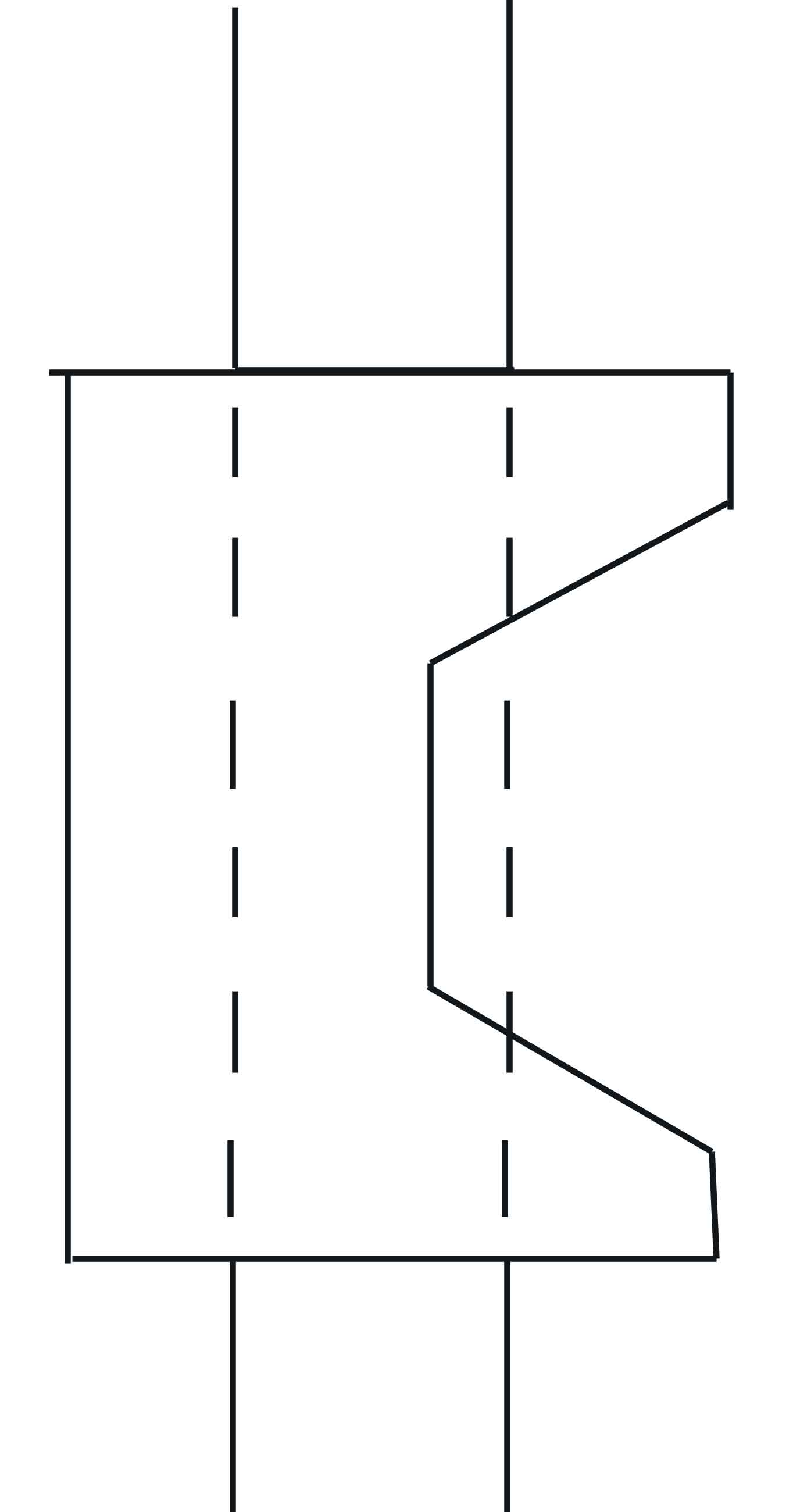

Wed, Sep 15, 2004 at 8:59:41 PM | RE: Santa Wants a Chimney
Osir
Joined: Wed, Sep 1, 2004
43 Posts
I guess what I am wondering is, should you stop the wall on both sides of the chimney? See sketch.
Wed, Sep 15, 2004 at 10:05:14 PM | RE: Santa Wants a Chimney
Mr Spot
Mr Spot Avatar
Joined: Mon, Jan 12, 2004
2889 Posts
4.5 Stars: 93 Votes
It would probably be easiest, and most correct, to use the opening tool in the modelling tab and sketch an opening in the wall where the fire place is to go...
Wed, Sep 22, 2004 at 1:01:22 PM | RE: Santa Wants a Chimney
Osir
43 Posts
I ended up making an In-Place Wall family for the exterior chimey that did not cut the walls, then inserted a firebox component that a fellow architect gave me that did insert itsef into the wall.
