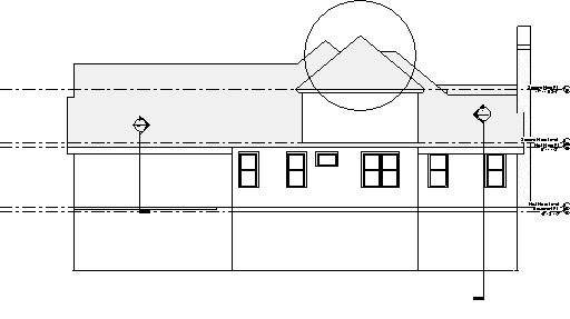

Here is the East Elevation from the house I'm working on. How do you get the roof to pitch up higher. The ridge at the left in the circle should be higher and the ridge at the right should join into the hip.

Hey djnadreneau, Yeah I feel your pain regarding the roots, they are a little akward. The first thing to avoid in my opinion: picking walls to determine the boundary. We've found that sketching is always the ticket, regardless of whether you're drawing ceilings, roofs or whatever. We find that complex roofs will inevitably be made from more than one structure, then anything is possible. You can join roofs that overlap and align the surface patterns on each face to each other to appear to be continuious. ICON: When you say that you usually only need a single footprint to make roofs, have you mamanged to overlap them (like when one roof extends over another, like the gables-within-gables on djnadreneau's first pic)? Post edited on 2006-06-26 20:31:08

ICON: But you are right, the bulk of your roof does tend to consist of the one footprint. djlandreneau: haha, there are other ways to learn Revit other than trial and error? Unfortunately this is pretty much it... basically go as far as you can with one footprint untill it stops acting as you want it (ie, wont slope correct, or you cant specify an accurate plate height), then supplement with additional roofs. If you could post a roof plan, people on here can draw over it what the foor sketch (complete with purple lines) should look like, which will solve all the problems. 'Export the current view' and post the .jpg up here (like you've done previously) and we'll sort you out. Does anyone have better advice than this? If there is an invincible method of Revit roofing that you know of, let us know... Post edited on 2006-06-26 23:00:04

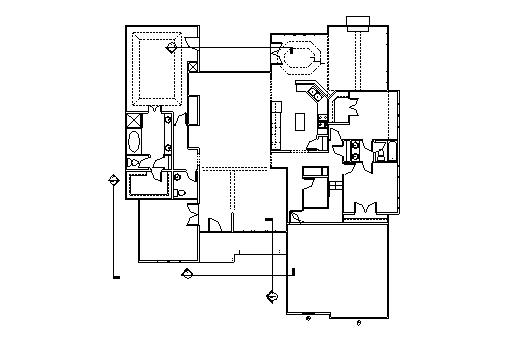

Here is the first floor plan. I purchased the DGCAD tutorials, but unfortunately all of the tutorials, DGCAD and others, only cover simple roofs.

the material in this mini-clip is not covered in the purchased videos HTH
