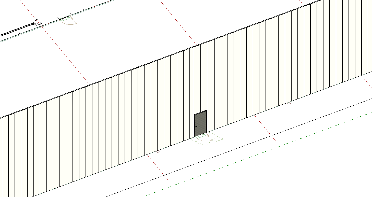

I'm working in Revit 2024 and trying to recreate an existing building from dwg. the building has 3" fabricated metal panels, so it needs to have a vertical line that shows up every 1' 10". I have not been able to figure out how to create a wall with this feature. I ended up using a curtain wall system, and making it have no horizontal mullions for inside. but then when I need to place a door, I have to prake the wall and make a new one that has 1 horizontal line, and editing it so that I can place a door. I have attached a sample of this. it's a big project and it's going to be a major pain. and this is typical of most of the buildings that this company works on. I need to find a better mousetrap for this.

I used a 3D material for this.
