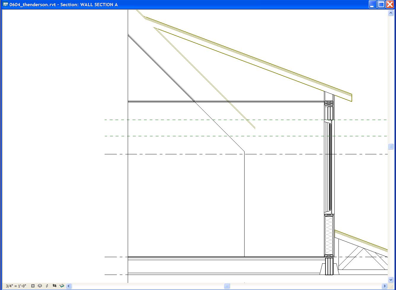

How do I hide core elements of a roof or wall? I have tried to modify the core lines in the wall section using the linework tool but it does not allow me to select the core lines of the roof. Is there a diferent way to hide these lines in a wall section without using a solid white filled region?

If you're wanting to hide the lines so that you can detail it, consider this:
When you use a repeating detail component, the component will hide whatever lines are 'behind' it in the drawing.
With that in mind, there are 2 ways to accompolish what you are wanting to do. 1) Use a [repeating] detail component. 2) Using View Properties ('VP'Winking change the view's detail level to course.
