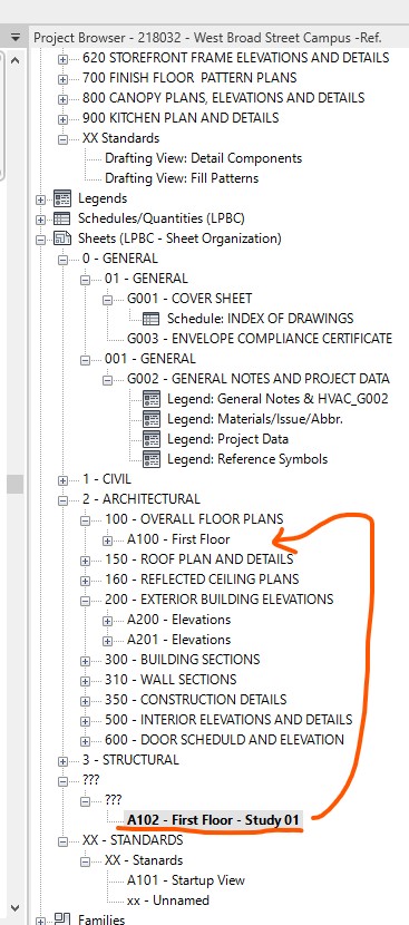

I made a new sheet.  How do I relocate the sheet on project browser?
How do I organize sheets on Project Browser?
Please, see the attached image for your understanding.
Thank you. 😀

For your specific Querry, In the properties, Assign Sub-discipline and View group as Architectural and Overall Floor plans respectively (or use similar logic because the names may vary)
