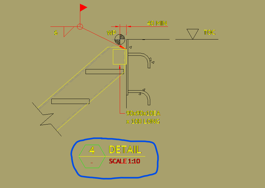

Hi Guys,
I've started working at a new company that is getting their rescources together for typical details in drafting views.. they are missing a few things. and one of them is a fake drafting view title for drating views that i can placed within the drafting view itself (see attached pic as an example) can anyone point me in the right direction as to where i can download one of these? it needs to have dynamic properties so that i can change it from a Title, Section, Detail and Elevation.
Thanks Guys
Thu, Feb 29, 2024 at 10:53:27 PM | Fake drafting view
Faking almost anything in Revit is a big mistake.  There is no need to do that!
Creat your dynamic callout in revit as a drafting view and paste your standard detail in that.
