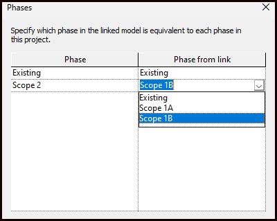

Greetings.
I have a project with 2 building models.  Each model has phases.  All models are being developed at the same time.  The construction will occur by phase:
SC1a and SC1b are in the same model.
SC2 is in the second model.
Construction will occur in this order; SC1a then SC1b then SC2.
The issue is with the graphics of SC1b work in the SC2 model.  The SC1b work should be shown as Existing.  The image shows our phase mapping ...
The only way we can achieve this is to add an additional phase (Project Completion) to the 1st model and change the mapping of SC2 to Project Completion.
This doesn't seem correct but I cannot find any other solution.
My concern is that if we create a "Project Completion" phase in the 1st model, then all new views in the 1st model will default to Project Completion and this could lead it issues.
Please offer your thought's ...
