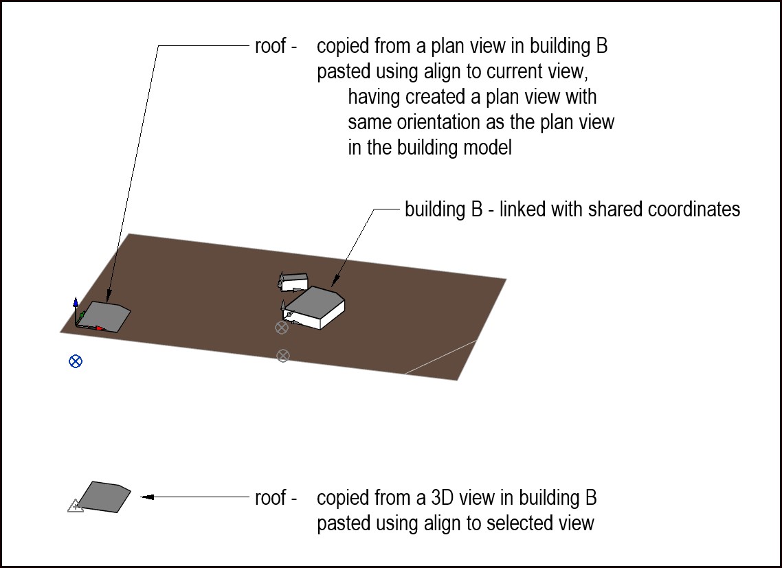

I have a project containing a site model and 6 unique building models, all arranged with shared coordinates.  We want to be able to copy elements from the site model to the building model (and vice versa) however the elements do not paste to the correct location.
After some research, pasting the elements relate to Project Origin and not Survey Point; so the shared coordinates doesn't appear to help.
I have created similar plan views in the site model, hoping that Align to current view would work but no success.  Short of creating lines or reference planes to locate the elements after being pasted, is there an efficient way to accomplish this?
