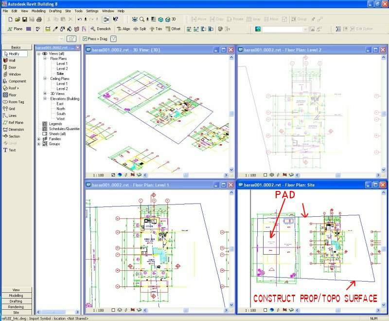

Sun, Jun 18, 2006 at 5:59:24 AM | RE: Solution 2D DWG to REVIT Pls
kamo
kamo Avatar
Joined: Fri, Jun 9, 2006
12 Posts
heres my 1st try . NEED COMMENTS THANKS

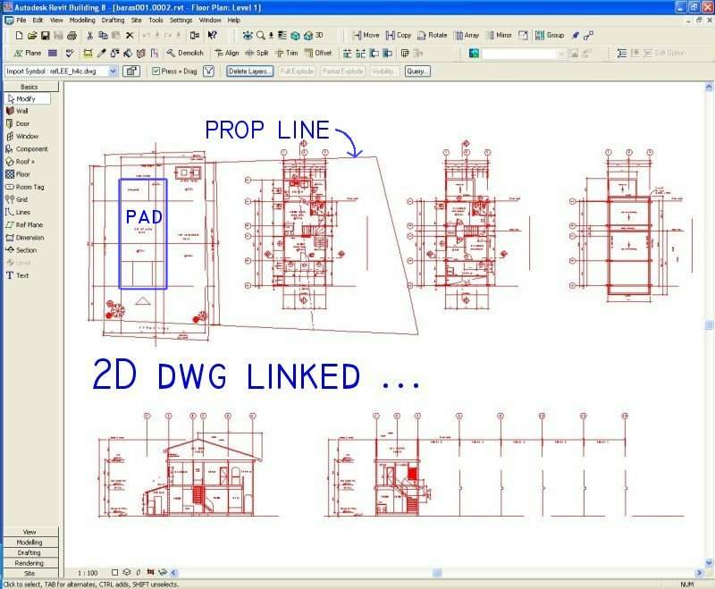

Sun, Jun 18, 2006 at 6:04:13 AM | RE: Solution 2D DWG to REVIT Pls
kamo
kamo Avatar
12 Posts
cont ...(cannot attach 2 files a time) to construct topo/pads from dwg file (linked). Post edited on 2006-06-18 09:45:54
components-sizes small..pls help
