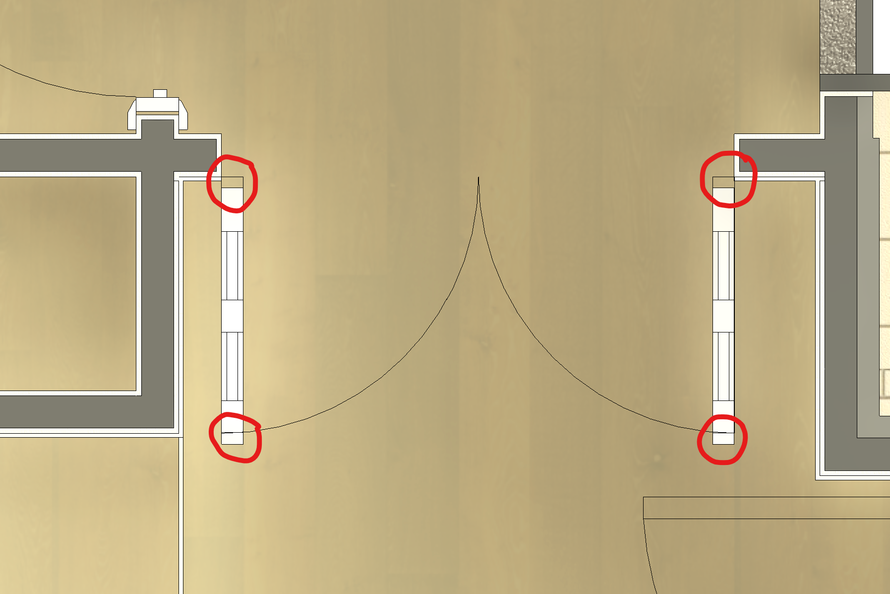

Hey guys, I've been playing with a family of parametric double doors so that they can appear as 'open' while navigating through in enscape. After a lot of tinkering I've got them as close to my intention as possible, however the door panels are appearing about 25mm away from where they should be hinged for some reason. I've attached a screenshot to show what I mean and added the family too if anybody wants to have a look.
Any suggestions would be greatly appreciated.
Cheers

The problem is in the family.
