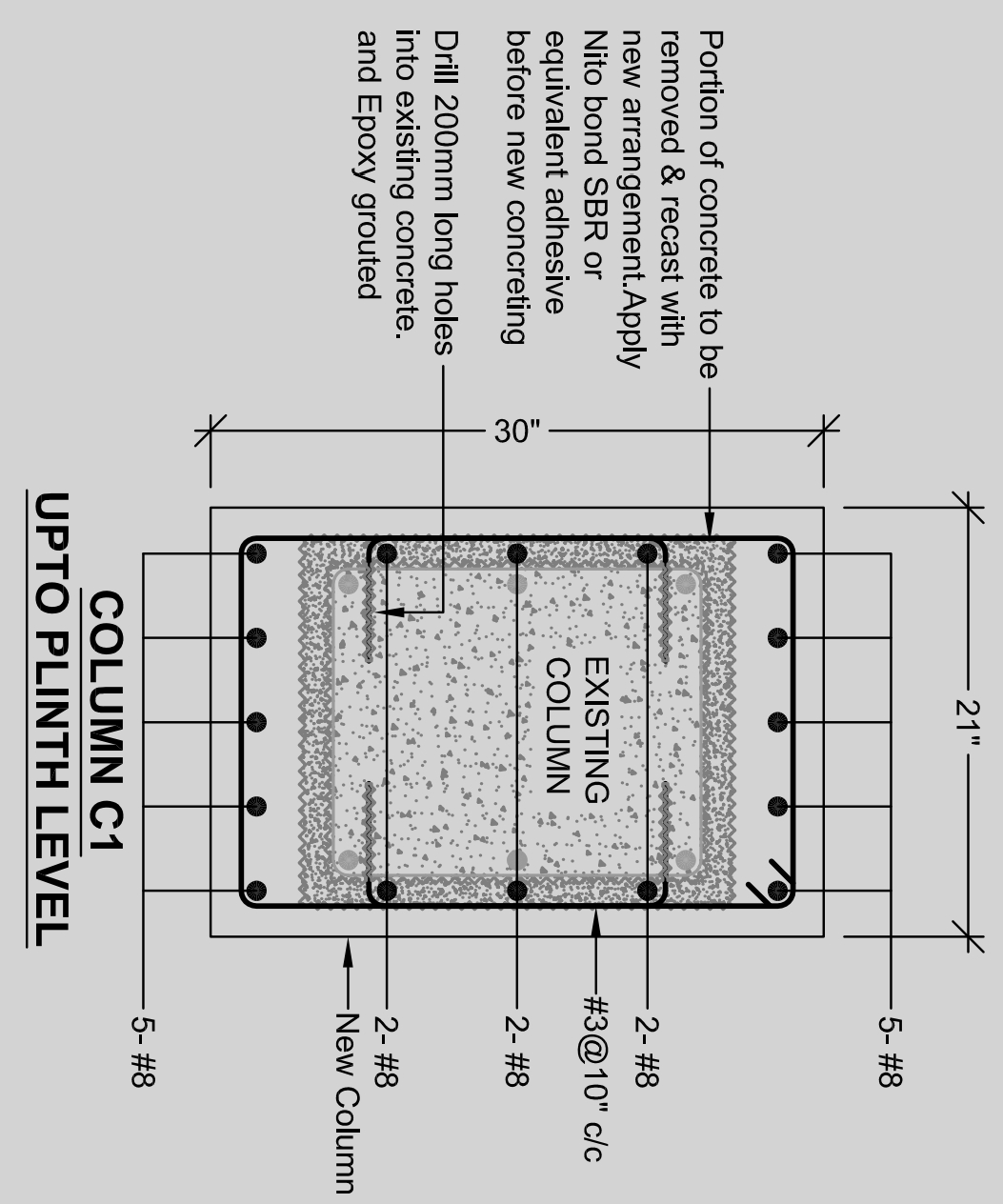

I have to demolish cover concrete from existing columns, tie rebars, apply a chemical coating and pour new concrete according to new (increased) size.
How can I model the column cover concrete demolition in revit?
Voids not working with phasing.
Thu, Sep 29, 2022 at 10:52:00 AM | Partially Demolish Columns
I think this is something I would not model.  Handle it in the details.
Fri, Sep 30, 2022 at 12:33:28 AM | Partially Demolish Columns
mak213
Joined: Mon, Jul 6, 2020
0 Posts
I thought modeling it might make it easier to prepare bill of quantities (BOQ)/ BOM. But yeah, a better approach for preparing IFC would be as you said, just to handle it in details.
Thanks mate.
