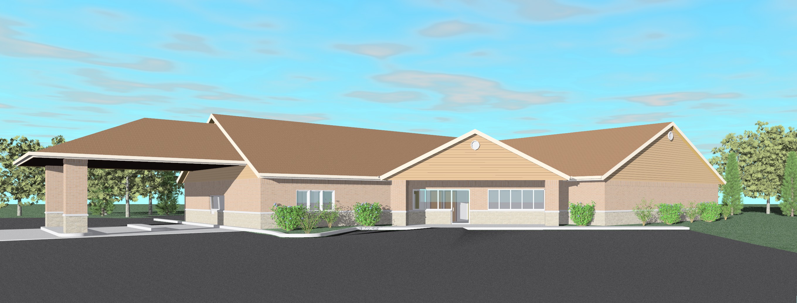

Newer user to Revit and love the program , but bosses are wanting more Phot real type rendering not so cartooninsh if you know what i mean. they compare my revit drawing to a AE firm and say can we get your like that! How can I do this, is it just in the way you render or are they useing another program besides Revit!

You are never going to get a photo-realistic rendering out of Revit and its default rendering engine, Accurender. The power of the software isn't its rendering capabilities, its in its database capabilities. Accurender is just a bonus for doing "ok" renderings. However you can use third party software like Autodesk Viz to render models created in Revit - it will take some research, but people do it all the time.

Hey jmiller, There are alot of tricks you can use but bear in mind that many lives are spent trying to capture reality. While hjacobs is right that Accurender is more than a little behind Viz, Max and other leading rendering programs, I think it still has potential. In regards to your image, could you post the raytracing settings you used to get that image? Its a great start, and good on you for being so willing to ask for help - I hope this does just that! Some points: Try and hide that horizon line. So seldom do you see such a straight line in photos, experiment with background photos and trees placed back from the building. Those clouds seem a little grey, again you could try making them white or using a background image. And the sky could be a little less green... Download some cars from this site, they render out real nice - and its a good idea to balance compositions with background and foreground information. At the moment your whole picture seems to exist at a similiar distance from teh camera. You could try having some massive trees on the left (off camera, out of sight) and have their shadows casting over that massive area of pavement. Email me with more questions if you like, you're on the way! Post edited on 2006-06-14 17:06:06

after you have finished the rendering, use the adjust image tool to change the brightness and contrast. then take it in to photoshop and do what has been suggested. put in a good background that blends well with your biew, then make some layer changes. for example, most of the time, you can apply and overlay layer to your image and that tends to make things look quite a bit better. but like its been said, unfortunately revits rendering engine is not quite as powerful as the others that are available.

Thanks everyone for the replys. I have a coupld more question! what is the best way to hide the horizon line, with trees change the grade at that point? What is a good setting for raytrace i juast have been using the default settings Thanks

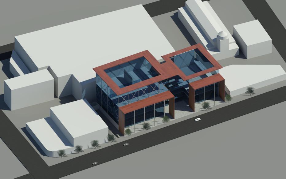

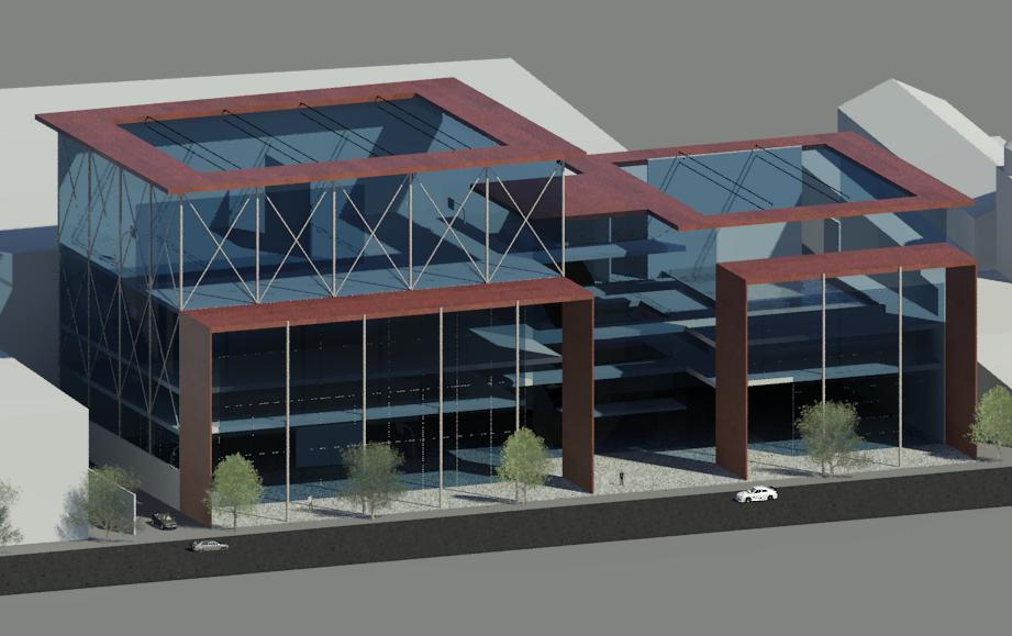

can someone just clarify something for me about revit rendering? by the way, i have attached the worlds crappiest renderings to this message so u can see where i am at, because i want to make them look a lot better but dont know how...
 my question is...when u render in revit (just using the rendering tab) you dont get an option of what type of rendering engine u want, right? when i do it, i dont see an option for rendering engines, so i assume it is using some sort of default rendering engine. i see ppl posting info on accurender, mental ray, etc. what kind of rendering engine do i have and what kind do i  want?

Revit 2008 use the Accurender engine and Revit 2009 use "Mental Ray" engine, you can't choose "of what type of rendering engine u want"
 What you can do if you aren't satisfy with your renders in Revit is "insert" your model in Max and use the "V-Ray" to create your renders....
