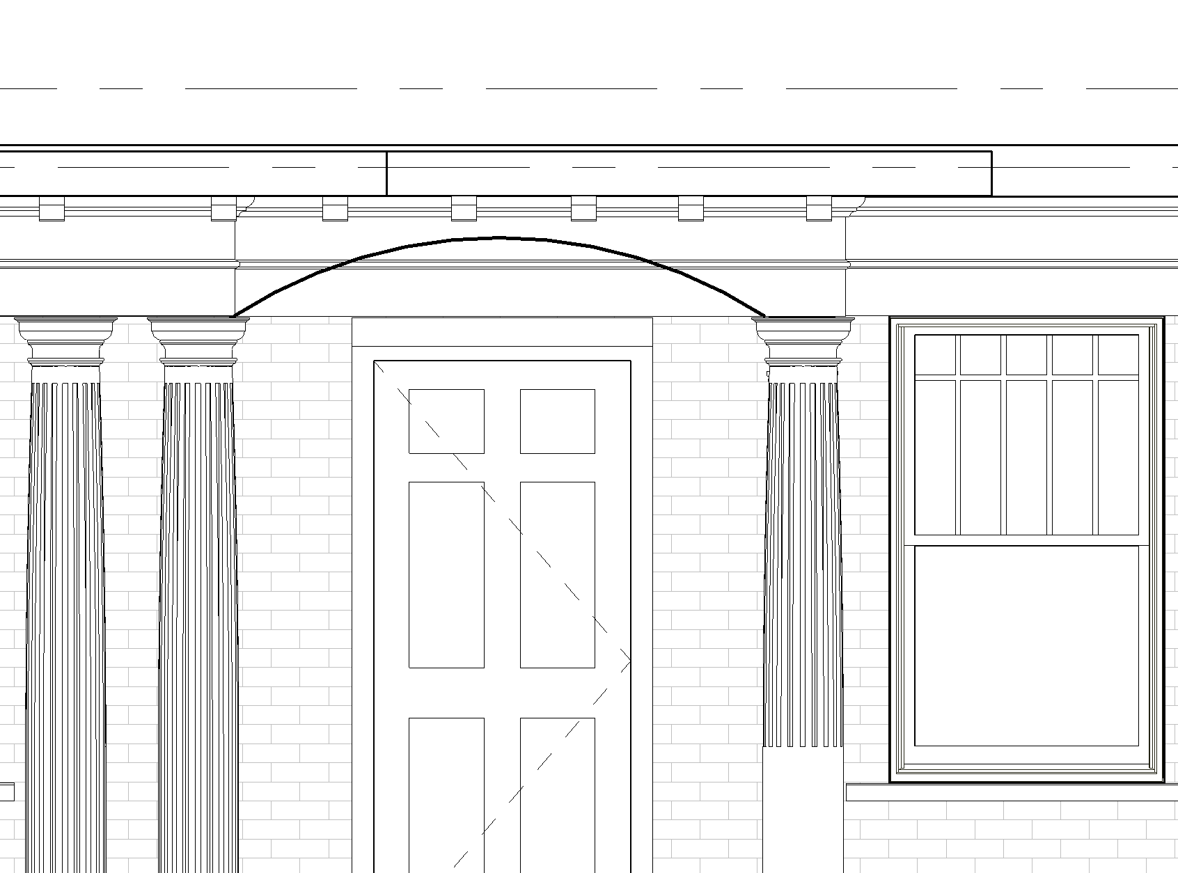

I'm trying to cut an arch opening through a sweep with no success. Void Models not working.. They will cut wall behind the sweep, but not the sweep.

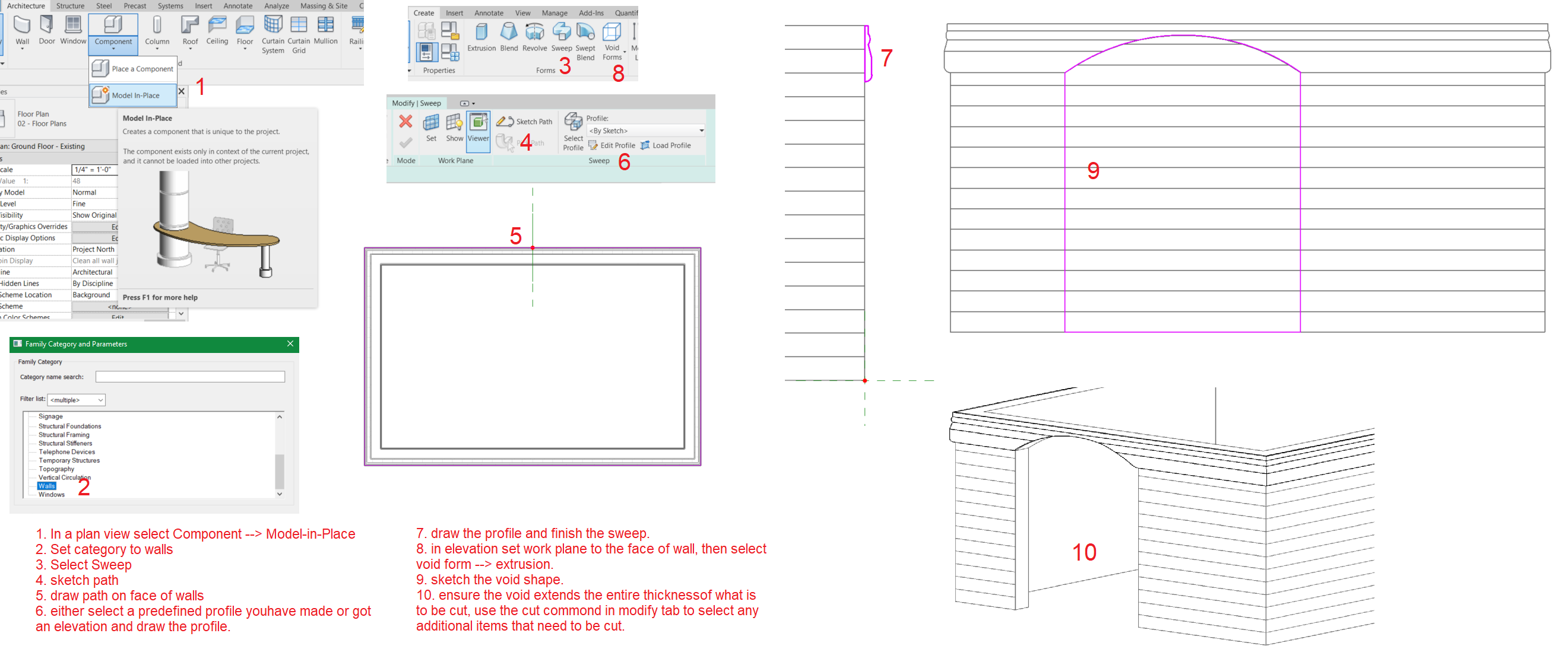

How are you creating the sweep? I believe the only way to get this done the way you want is the model in place (Architecture --> Component --> Model in Place). Then make your sweep (in plan view so the path can follow the building footprint), next you will make a void extrusion in elevation in th shape of the arch where you want it and use that to cut the sweep. Then finish the model in place command and voila.

This cannot be done using the wall sweep command. You need to create a model in place family following the steps I outlined. Sake a sweep and draw the path in plan then either draw the profile or apply a profile shape family.

here is a detailed step by step guide on how to do what you are asking.
