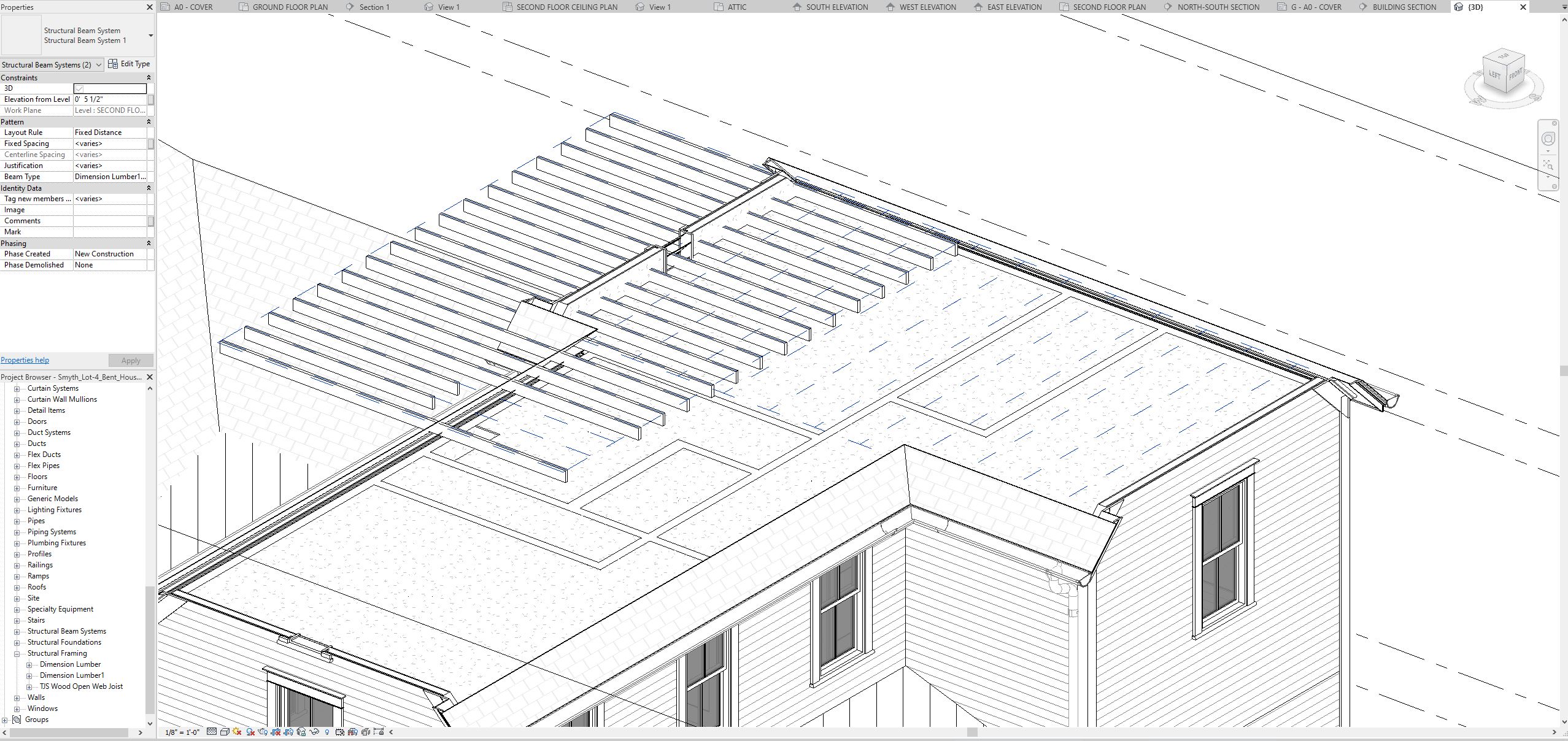

I've had the same problem on the last few projects I've done. When I put in a framing system, the members of the system don't show in any view. I've done several searches and followed threads about discipline setting, view setting, object setting, etc and none have helped. I finally found a prevision project that had systems with visible members. I copied and pasted the system into the current project and have attached a screenshot of the result. The structural framing families are the same in both systems, yet the one I created in the new project has no visible members. What could be causing this problem?

The display of structural components differs based on the detail level of the view.
For example, structural framing appears as sticks in coarse detail level, but has much more detail at medium or fine detail level. Detail Level is a view instance parameter; therefore every view can have a different setting for this parameter.
Detail Level is also view scale dependent.
