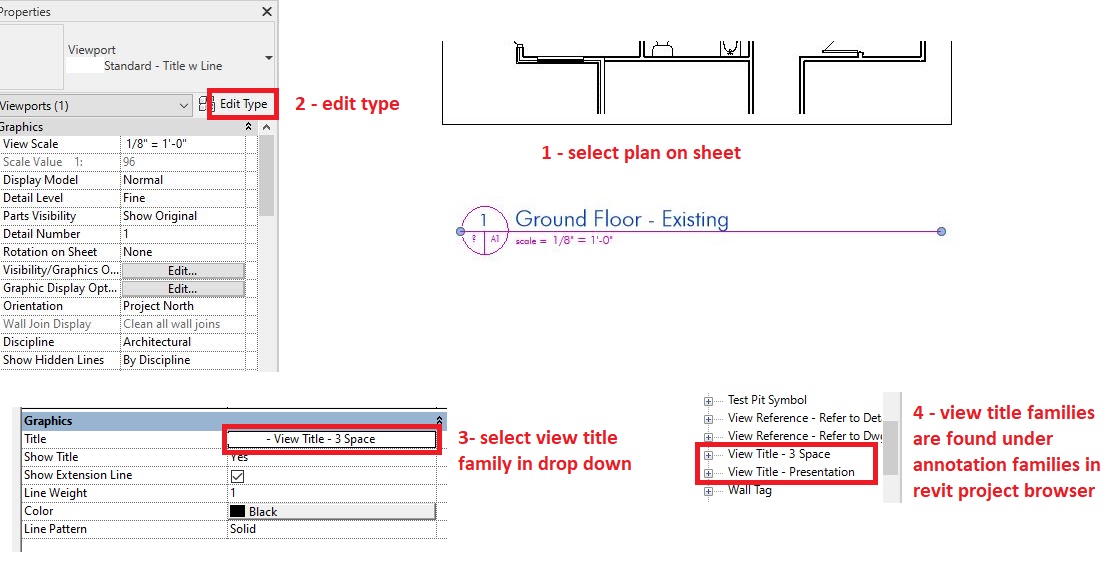

As WWHub said view title families are like any other family in Revit. The difference is that Viewport families (what you see on sheet) use the view title family as a nested family in their properties. You need to make a new view title family and a new viewport family that references the title family if you want it t be different. See pic for the steps.
