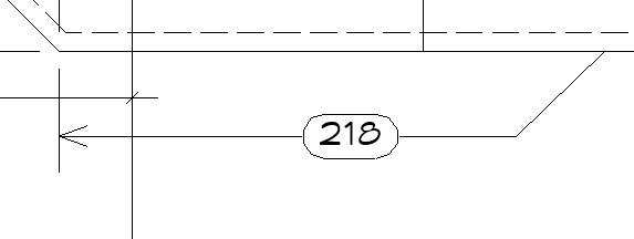

Is there a way to only have one arrow on a 2 leader note bubble?

I do not believe this is possible. The only work around is to use 2 different tag types (one with arrow and one without) and then align the tags over one another so it looks like one tag.
