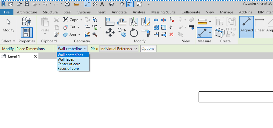

Can't get my dimension strings to snap to the face of a wall or stud.   All the other snaps seem to work normally.   Anyone else experienced this and if so found a solution???

See pic. Select wall faces from the drop-down.

Thank you!!!
