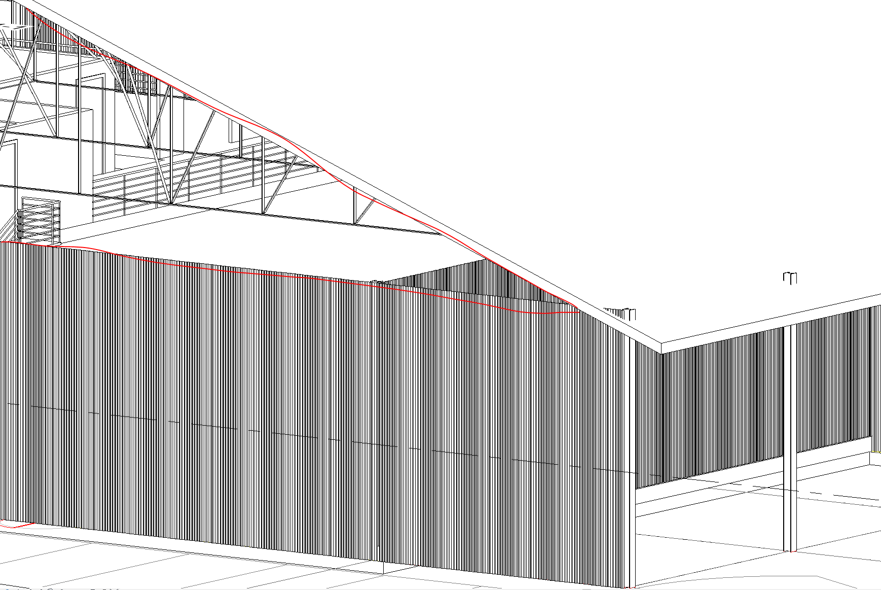

Hi all,
I have a question when building the warehouse. The exterior walls are metal cladding and I built they with profile curtail panel. They work perfect with rectangle wall. But the problem is I need them attach to the slop roof and they failed. Does anyone know how to solve this problem? I know there is a way I can pretend that I have metal cladding by using mullions but I want to know if there is a way to make it real metal cladding walls. Thank you so much!
Sat, Jul 24, 2021 at 8:17:45 AM | Question for metal cladding sheet as curtain panel attached to slopped roof
You never want to model siding - use a material instead.  This post is old but it still applies: https://www.revitcity.com/forums.php?action=viewthread&thread_id=17756  I checked out the steel select site to see if they still have the Revit textures and they do.
So model your wall with a thickness and apply a material.  This will connect to the roof correctly and render correctly.  For plan and section detail views, you can place your profiles.

Hey thank you for your answer! I've learnt that I could use custom mullions instead of curtain wall panels to attach to roof. Smile))
