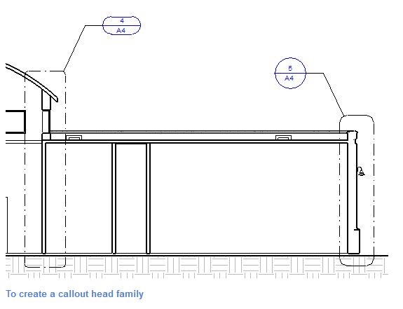

Thank you very much. This topic is not explained in Help. It would be great if you attached an image illustrating your explanation
Thu, Jul 15, 2021 at 6:09:04 AM | Section Family
The image below and this should help: https://gtu.ge/Arch/Faculty/Multimedia/Resources/Revit/Help/filesUsersGuide/WS1a9193826455f5ff662ffb11407b58d52-5bd3.htm
