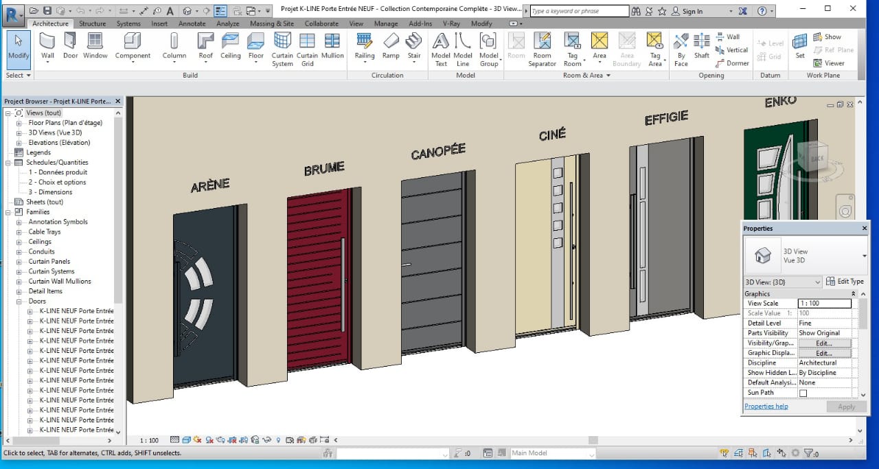

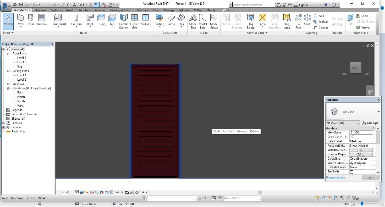

Hello| I've downloaded a door family but when I tried to copy paste in my project the handle is not visible  Can anyone help me in this regard...
I've attached screen shots herewith .  Thanks in advance
Mon, Jun 7, 2021 at 5:46:44 AM | Door handles not visible
The better families are always created so that only necessary items are shown at appropriate scales and detail levels.  In your case, I believe the handles only show at the 'fine' detail level.  Change that setting in your view.
