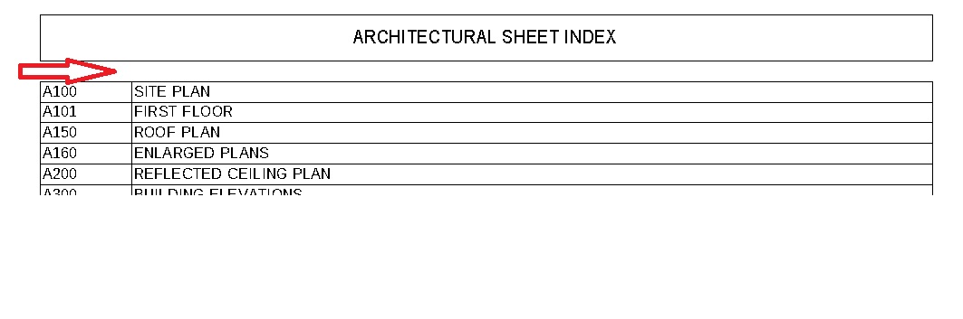

How do I remove the space between the title and data rows and join them?

In the schedule view, schedule properties – go to appearance tab and uncheck ‘blank row before data’.
