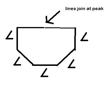

Im newish on Revit. How would I model a half teepee style conserative on the gable of a house.
Thats like a half indian tent.
Thanks
Paddy
Mon, Mar 8, 2021 at 12:43:27 PM | Model teepee
This would be a roof element so model it as such using a roof plan sketch.
I don't have Revit here but this is a plan of what you do.  All of the faceted side eaves would have a set slope. No slope for the rake side which is two seperate lines that meet at the apex.

Thanks, I have done that and changed it to glazing but now i need to show frames at the junctions of the glass.
This is the part im having the problem with.
Again thanks
Tue, Mar 9, 2021 at 6:56:50 AM | Model teepee
Ah ... I missed the term "conservatory", we do not use that term in the US.
I would think about using an in-place family, an extrusion along one of the ridges.  Then copy / rotate tha from the center (apex) to the other angles.
