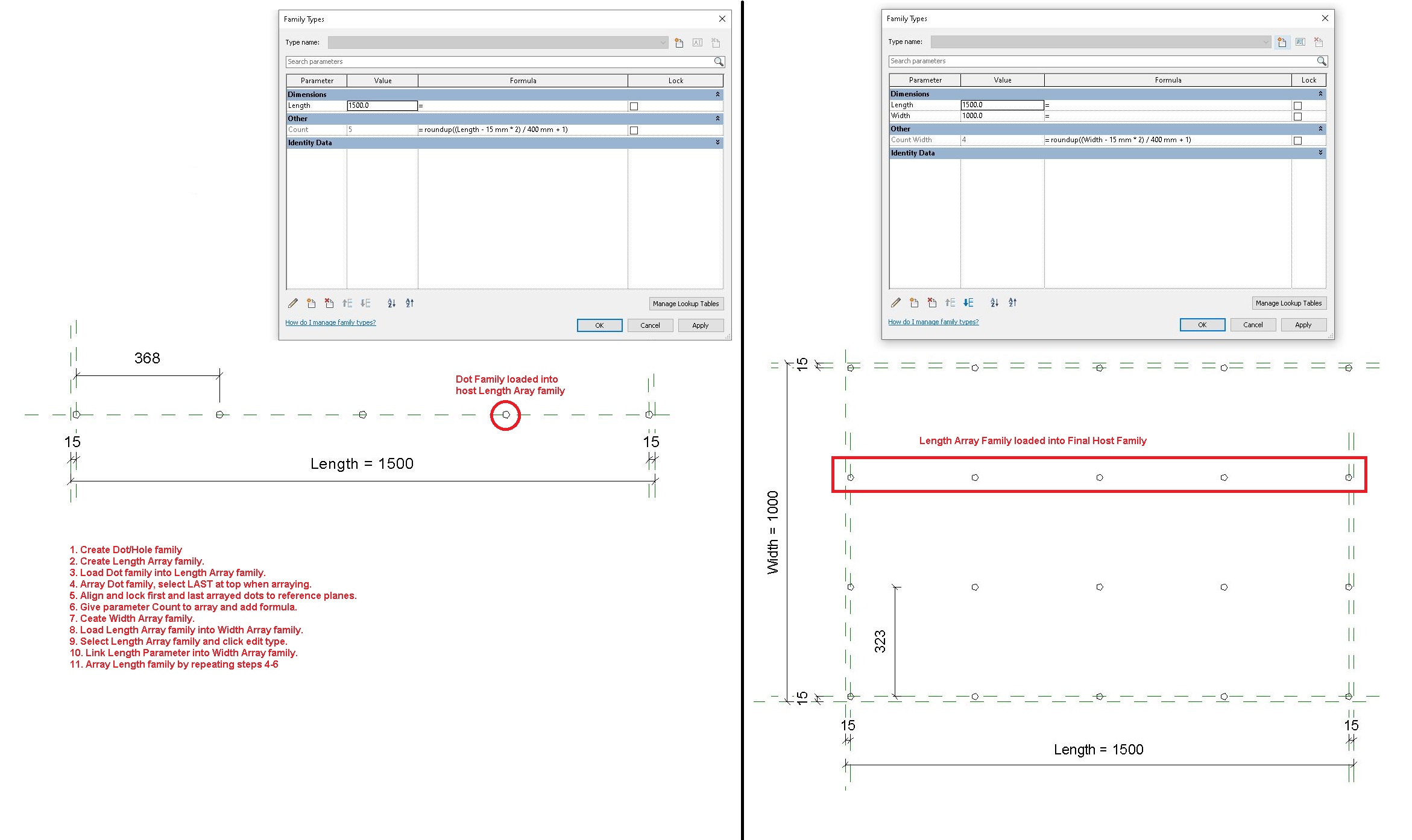

Hi There,
Wondering if you can help me, Im sure this must be easy but cant work out how to do it.
I am trying to create rectangular plates of varying sizes. I need to show holes 15mm from edge and then equally spaced around 300/400mm centres related to the width height parameters.
I have tried parametric arrays but cant get it to work.
Any advice greatly appreciated..

marmiketin1
Joined: Wed, Aug 19, 2015
0 Posts
4.5 Stars: 10 Votes
Follow the posted steps int he attached image to achieve what you are looking for. I have also attached the family (Revit 2020)
