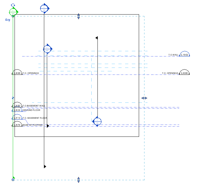

Hi everyone, is there a way to deit Section type property  (it is not a Detail section) not to have them seen in an Elevation views? For callout type, there is no NONE option. Please see the image
Thanks a lot

The problem is that i draw these sections (which we see as callouts) in plan as Sections.Not Detail, but just sections. There is only one Section type in the project. Why do i see these sections as callouts?

I have drawn these things in plan as Sections. I don't understand why they are visible in a parallel section/elevation view as callouts.

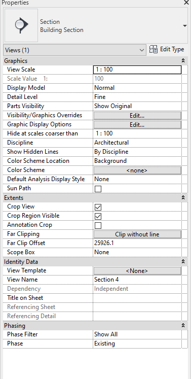

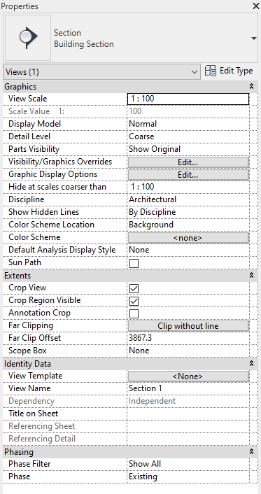

I see these "callout like sections" in some parallel sections, but in some i don't see them. Both of these parallel sections are intersected by view range of "callout like sections" . Please see properties of one which shows these 'callout like sections"

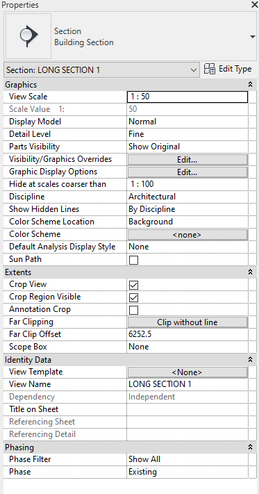

It is a section, the same type. Elevation shows the same thing
161042_North_View_Section_Instance_Properties.png161042_View_from_the_North_Section.png

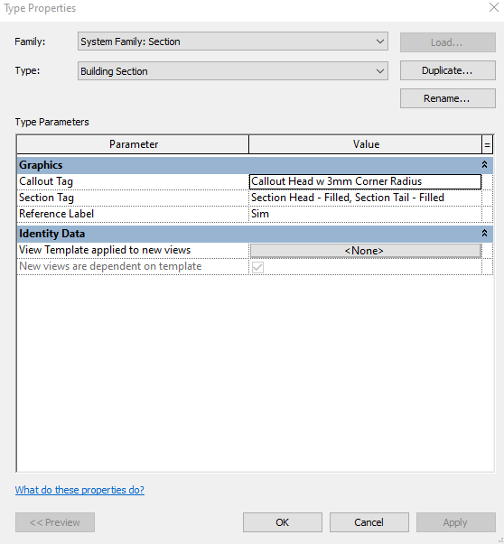

Another friend told me you used the callout tool, but selected the section type. When you place a callout you can tellit that this is a elevation callout, detail callout or section callout
either that or they placed a section in a perp view and it's showing up here as a callout

No.
I opened a plan view, selected a Section tool (Building Section type), and draw a section.
Opend a parallel section and saw a callout.
